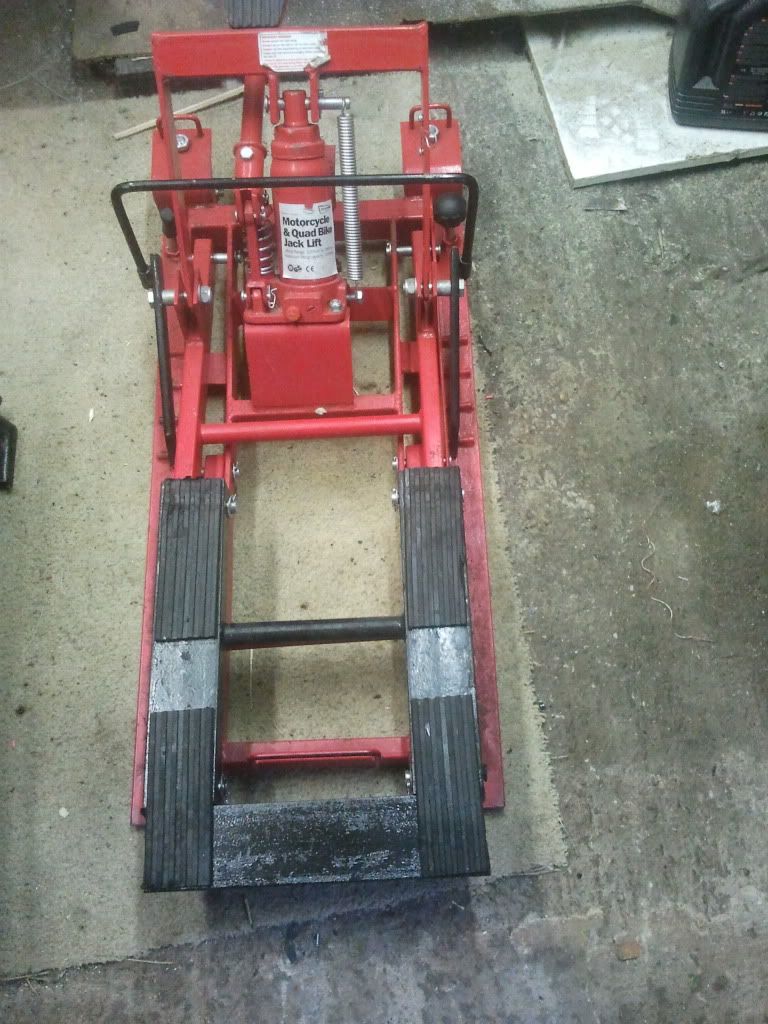

Hi just added 3" to the reach of the jack, I found it to awkward to use as it was,as it just about sat under the rails.It now sits with room to spare each side and makes me feel more comfortable.

Cheers Dave,it is well worth doing I got hold of an old gate post 3" angle iron,well enough for the job and as I said it makes you more comfortable leaving it up for periods of time,without worrying.
PostSubject: Re: Added 3" to motorcycle jack   Wed Feb 15, 2012 10:16 pm
What will you do for the new end, cut up an old car matt and stick it on?

Good idea, is it just a weld-on Alfie? And yeah like MR I says, you gonna rubber the new bit of plate?
PostSubject: Re: Added 3" to motorcycle jack   Thu Feb 16, 2012 8:51 pm
Cut a peice of the rubber that sits in the middle,it was doing nothing and saved me more money,(times are hard).Yes Joe I welded it on,and believe me it wont come off without an angle grinder.

Just incase you did not understand what I ment here is the finished product.The part were the rubber is missing does not need it,for there is nothing to be supported under that part.
PostSubject: Re: Added 3" to motorcycle jack   Fri Feb 17, 2012 7:48 pm
Excellent job Alfie, That extra few inches will make a massive difference. It annoys me making sure the thing is under it right before lifting.
