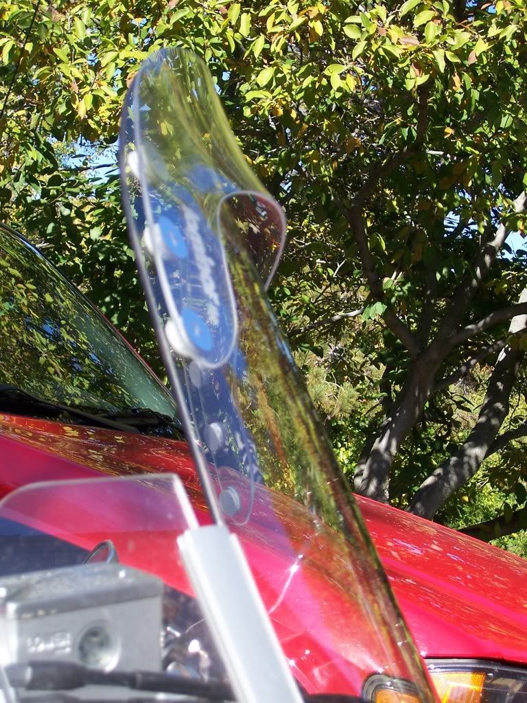

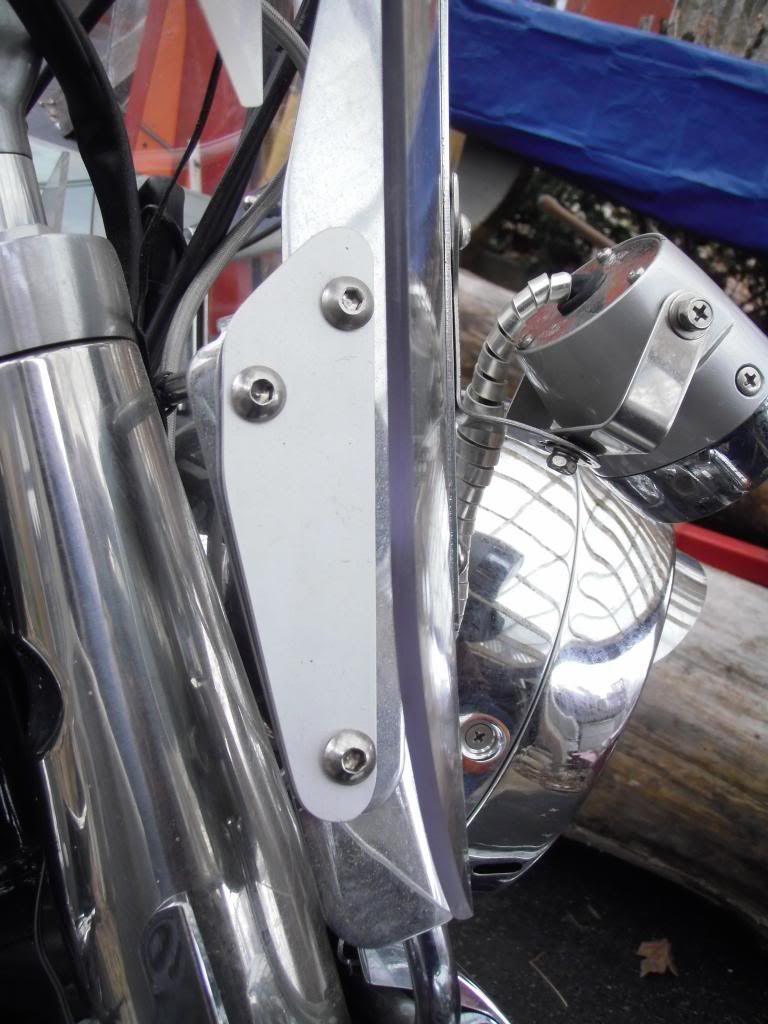

The Suzuki OEM screen slopes at the same angle as the forks for aesthetics but will actually provide more protection from the wind if tilted forward more. Some riders do this by removing the two upper windcreen bolts (one on each side), tilting the windscreen forward pivoting on the lower bolts until the bracket clears the upper bolt holes and then re-installing the bolts and letting the windscreen mounting bracket just sit back against the upper bolts. (The windscreen is still fairly secure because now the bottom of the windscreen braces against the fork legs).
When I tried this I was surprised how much improved the wind deflection was so I made a permanent aluminum bracket so I would still be fastened with the upper bolts. I also have a Laminar Lip deflector at the top of my windscreen.

That's very interesting CB. I do not have a screen on my Intruder but have recently been experimenting with screen angles on my V-Strom where I have found the opposite actually applies! With a forward rake I find too much head buffeting but when pushing the top further towards the rider I get a smoother ride. I always thought screen air flow control conformed to the same principles regardless of the motorcycle but perhaps this is not true and it depends on the shape of the front (fairing/naked etc). Interesting! I also see your screen has a spoiler which may react differently than a single piece screen.

Hi John if you look at my screen you will see it agrees with your logic,I like many others on this forum have had many bikes over the years and have always found that the more you tilt from front to back the better the wind passes,regardless of what vehicle you are on CB when you say tilted forward more do you mean tilted towards the back of your bike?.
