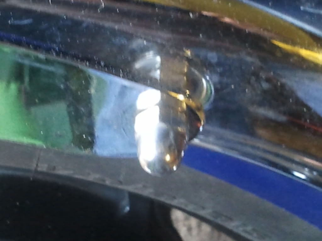

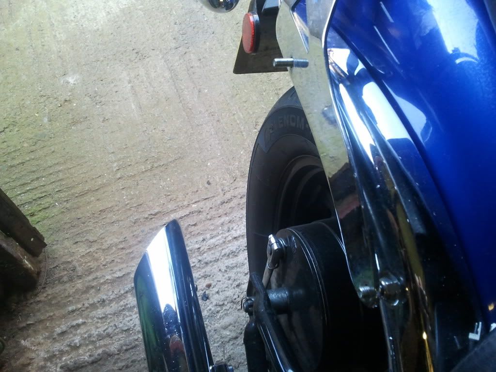

Hi Tim I have both hard (givi21)and soft luggage,you can make them interchangable easily with home made brackets,if you want secure(lockable) then go for hard luggage,keep loking on ebay.You place the luggage on your bike with a pillion sitting in situ,then work the brackets out.Also with hard luggage you will not have to get saddle bag supports as the fact that it is hard luggage tells you it will not get in your rear wheels way.What a lot of people do (I have done it) Is reverse the two top bolts in your rear fender,the one nearest the tank has the nut welded on the inside just take it out and drill the nut a little bigger the size of the bolts are 8mm /80mm I think.This then makes it easier to make your brackets,and easier to take luggage on and off as you feel,when I get chance I will photogragh the idea for you.Hope this helps a little bit and good luck on your retest.
PostSubject: Re: Kitting out the Suzuki VZ800   Thu Apr 05, 2012 9:34 pm
[img:c466]http://www.suzuki800.com/[/img][img:c466]http://www.suzuki800.com/[/img]Here are the pics showing the ends of the m8 bolts,as you can see when the bags are not on, if you use the domed nuts they will look better and protect your pillions clothing.The bolts are held on between the rear fender and the sissy bar by a lock nut.
PostSubject: Re: Kitting out the Suzuki VZ800   Thu Apr 05, 2012 9:59 pm
That's a levers impale but clever idea to spin the bolts cause they are real bitches and once bitten is twice shy with th in the right way

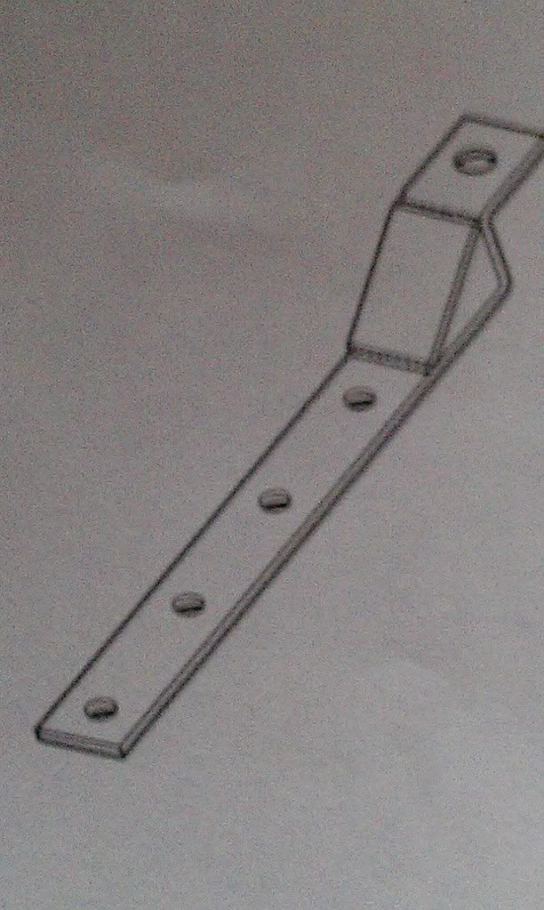

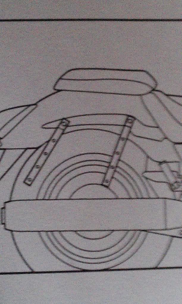

Hi Mal, Cheers, I like the panniers and they were very easy to fit, the brackets that came with them are quite sturdy, they're made from
30mm wide by 5mm thick metal painted black (difficult to see on a photo) I've taken some photo's of the brackets off the instructions, so you should get some idea from those,they're very basic and I would have thought easy to make.
The panniers came with a pre drilled hole near the top , then you attach them on the mudguard holder and get them in the right position before drilling the bottom holes,
Hope this helps ? if you need any more info or photo's let me know and i'll take them off to get some pictures.
PostSubject: Re: Kitting out the Suzuki VZ800   Tue May 01, 2012 6:10 pm
That's a massive help mate thanks .... and cheers for such a quick reply. I can visualise exactly what I need to do now.

Hi Mal if you have not already made your brackets the easiest way for you would be.
1: place your exsisting brackets were you want them to sit on the panniers,and mark were the two holes go.
2: drill the panniers with the corresponding marks and fit them.You can place a metal plate across the top of the pannier in the inside were the bolts come through to spread the weight.
They best thing to do with the the m8 bolts is take them out and turn them round,if you get 80 x m8 with domed nuts you will find it much easier.this way you can take the panniers off when not required a lot easier,and the domed nuts are in the panniers and not inside the wheelarch.I have found this the best way as I am always experimenting with different panniers,soft and hard.Hope this helps,good luck.
PostSubject: Re: Kitting out the Suzuki VZ800   Tue May 01, 2012 10:46 pm
Nice one! Yep those fender bolts are a pig aren't they... quite a struggle to line up having taken them out, so you're right, reversing them would make pannier removal easier. My new panniers were uber cheap & didn't come with brackets, so keeping my eyes open for something to recycle. They also have LED lights, so I've had a quick look tonight at wiring, but didn't get too far. Need to sus out best way of tapping into wiring at back end. There's what looks like a spare connector in the battery box - maybe....
