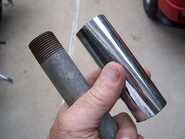

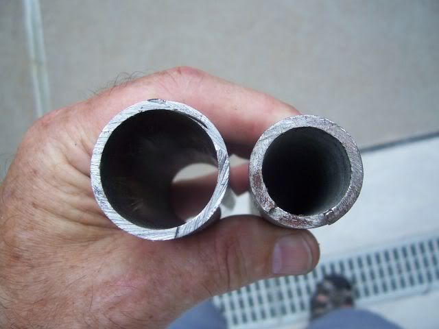

PostSubject: Re: Crash Bars fitted to C50T   Sat Apr 21, 2012 3:24 pm
Most makers now call their bars "Highway Bars" and it is true that many are not made in the manner of stronger bars in the past which had a full loop. My Cobra bars were continuous at the bottom but not at the top.
However, f the bars are cut in half midway between the lower mounting brackets you can slide a piece of gas or water pipe up the two sides of the bars to strengthen them.
This will accomplish two things:
It will made the bars easier to install, remove or reinstall because the lower brackets are no longer registered with each other.
It will strengthen the bars against for and aft forces since the maximum bending must occur in the tube of the bar right at the mounting bracket but now you have the reinforcing pipe present at that point.
This first pic shows a piece of the Cobra bar and a piece of 3/4" water pipe.
Here you can see the wall thicknesses of the bar and pipe.
...and here you can see the pipe fitted in the Cobra tube.
For Cobra bars on the C50 the pipe will need to be a little less than 12" long. The OD of the pipe is a little more than 1". There should be no concern that the bar does not have the same strength at the cut location as it will only experience about half the bending here compared to the outside location adjacent to the bottom mounting bracket. However the bars could be rewelded and painted black in between the mounting brackets and this would give them resistance to torque also.
