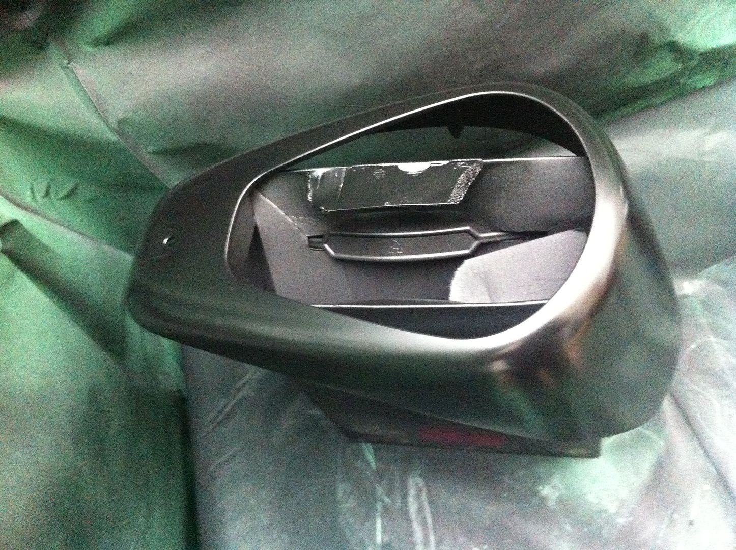

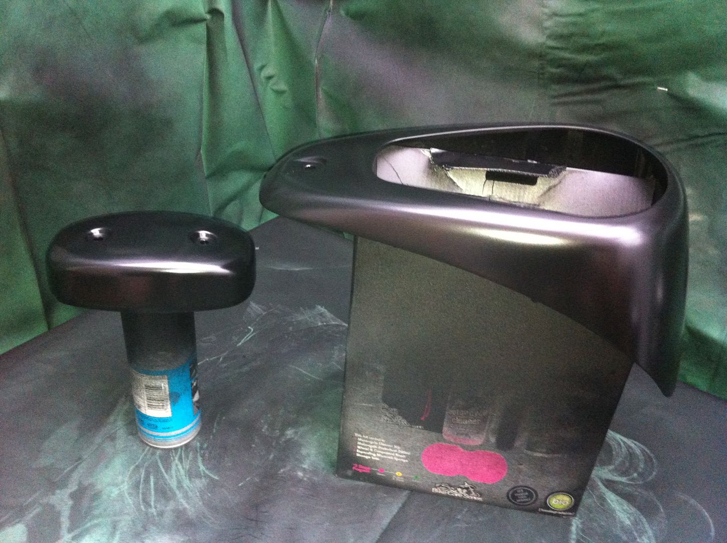

Clear coat was rubbed back to the black this morning while lots was going on in the kitchen and I new I wouldn't be missed. I will give it two coats of spray tomorrow and that will do until I can do it properly.
PostSubject: Re: Blacking Out Some Chrome   Mon Dec 31, 2012 1:41 pm
Did a bit of spraying today and the two parts I did turned out really well.
Sorry about the quality of the pictures, they are very grainy & make the parts look grey but they are actually jet black & silky smooth.
I sprayed them satin black.
Don't tell the Mrs but while the Cats away, the Mouse will play. So I turned our conservatory into a spray booth lol!
I will post some more pictures in the "done section" when they are back on the bike but they are now going in the boiler cupboard for a couple of days now to harden.
PostSubject: Re: Blacking Out Some Chrome   Mon Dec 31, 2012 2:21 pm
Looks good Dave
PostSubject: Re: Blacking Out Some Chrome   Mon Dec 31, 2012 3:20 pm
Looking good Dave,well done.
PostSubject: Re: Blacking Out Some Chrome   Mon Dec 31, 2012 3:52 pm
Nice one dave, be great to see how it looks on the bike
I was reading up on spraying stuff the other day and was suprised at how long spray takes to cure propely. Great idea to leave them in the boiler cupboard, that should cure them much quicker that way I bet alot of people have wrecked stuff that has been sprayed because they didn't know that, me included
PostSubject: Re: Blacking Out Some Chrome   Mon Dec 31, 2012 4:24 pm
Cheers guys.
