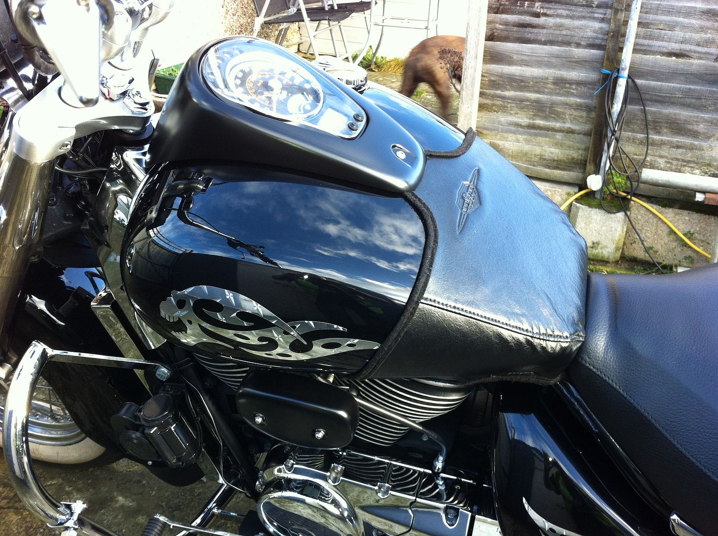

As you can see I have now started my conversion of some of the bikes chrome to black, kind of in line with the new 2013 1500
My original plan was to go with the stock "nebular black" paint which I have but I think I am preferring the silk black that I have on there at the moment.
The whole thing up to this point has had about 11 coats of paint in about 4 stages, with days of curing in the boiler cupboard. The last coats which went on yesterday have only had 24 hours of cuing as I now need to use the bike tomorrow for work, so I had to fit them.
I started by giving these (originally chrome) parts a good clean and a really good rubbing down. I then used a couple of coats of special metals primer and rubbed that down. I tried to find the Hammerite special metals primer as suggested by our resident painter Sim but couldn't find it in my local shops so bought an alternative. As it stands now it had 3 coats of primer, which were rubbed down with a fine grit between coats. After I had finished this it went in the boiler cupboard over night. It then had 3 coats of spray with a 15/20 minute rest before the 2nd and then 3rd coats were applied. It then went in the boiler cupboard again for a night or two before being rubbed down with a wet & dry fine grit ready for the next stage where I did the same and again put it back in the boiler cupboard for curing for another couple of days. As already said the final coats went on yesterday and was put in the boiler cupboard for another 24 hours, I would have liked to have left it in there for a lot longer really but as I now need the bike I had to fit it. Luckily the parts sprayed are not anywhere that will get knocked in any way so they should be fine, especially when you consider how much curing time the previous coats got.
Be careful when spraying to ensure the parts and spray are at room temperature and that the atmosphere is dry. I originally attempted this within a cold shed after it had been raining for days and it ended up looking like shit & I was forced to rub it all back down again.

Cheers Guys, I really like it the way it is with satin black so will probably just keep the nebular black for touching up the frame & so on now. Morgan I haven't clear coated this at present but would have done if I had used the nebular as originally planned. I will probably not clear coat the satin black as although it will help protect it, it also means that should I need to touch up a piece it becomes a lot of work. I will probably do the tail light next & will also respray the gloss black sections of my new M109 spike air filter to satin as well when that arrives.

Tex I am not a heavily experienced rattle can sprayer but do usually get the finish I want on the occasions that I do it, so follow my advice with caution. I used roughly a 1000 grit wet & dry grit paper between coats.
As for the sun reflecting off the chrome, yes this will certainly help with that.
