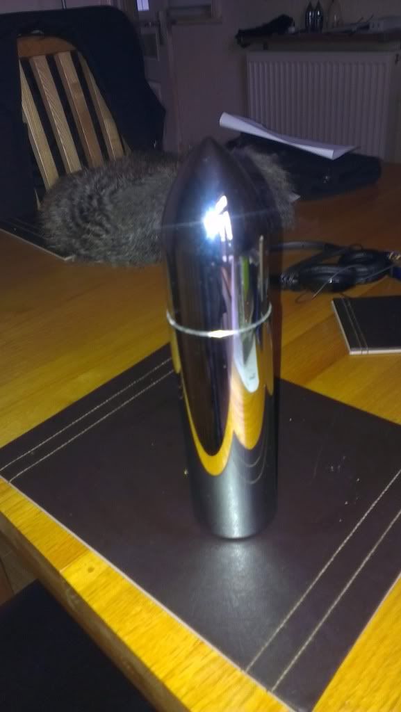

These arrived today, they won't slide over the bottom of the fork leg because the external diameter is the same as the fork leg itself, I'm not sure how I'll fit them yet :what1: At the moment I'm thinking aluminium tape (ducting tape) just wrapped around the joint, overlapping by about 10 to15mm either side but I'm open to suggestions

Yeah I did think about glueing them on, but it would only have a ringed surface of about 1.5mm in contact, I've got an exhaust trim with an internal diameter same as the fork lowers and slides over perfectly, I've made a little cut out on the nut cover and that slides inside too, So I'll cut two rings about an inch long from it and slide them over the joint with a little glue inside.

This is one, just slid on at the moment not glued on yet,

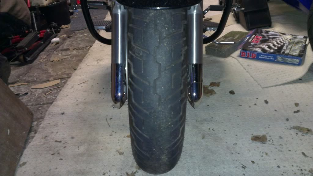

Here's both of them fitted, before I glue them on I'll do some photo's of how I fitted them.Cheap really as I ordered 4 nut covers, with postage they were £10 ish and £4.50 for a chrome exhaust end.

After looking at these today, I noticed they slide further up the fork leg than mine do and cover the hole for the spindle,
So I'm off to the car spares shop for another exhaust trim to make mine longer, with a notch cut out of the back to allow them to slide past the spindle hole, Damn ! that's another £4.50 on the cost of the job grrr not bad though considering the ones above cost the best part of £100.

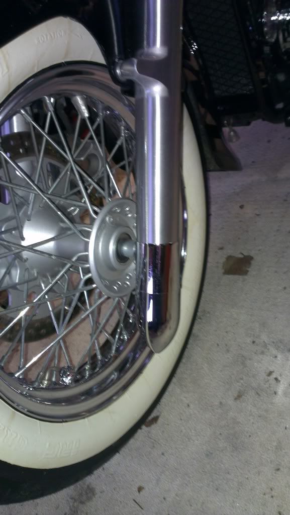

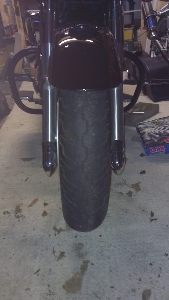

Today while sat at the computer reading the paper, I noticed the exhaust tube I'd got earlier in the week, Hmmm I thought, I'll fit them today

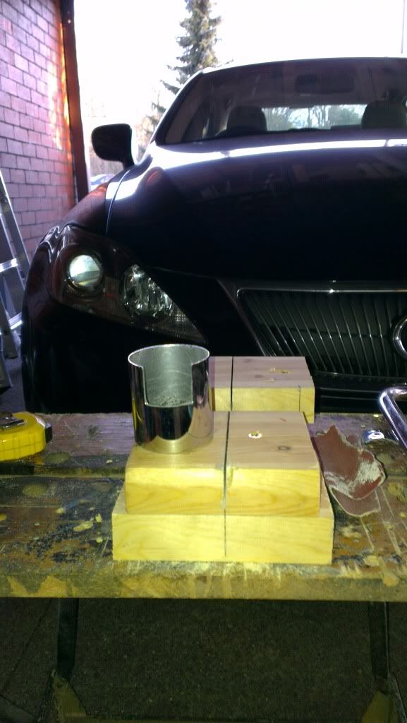

First of all I made a clamping device for the workmate so I could cut a straight line through the pipe, I just screwed some wood to it then mitered it at 90% so the hacksaw wouldn't drift off course.
Next having cut the desired lengths of pipe, I cut a notch out of the back so it would slide further up the fork leg above the spindle hole.

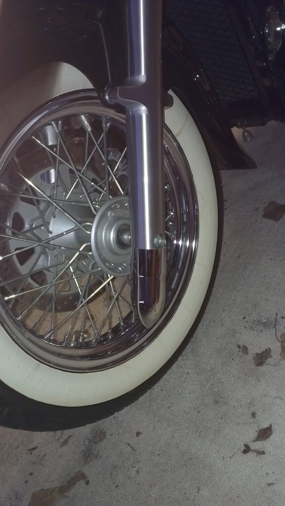

This is it slid on.
Then I cut a notch out of the domed nut cover so it would slide inside the tube.(tube and cover are the same external diameter)
This is how it looked.
I thought it looked good, so I went ahead and did the other side to finish it off, then stuck them on with a little (weak) spray adhesive. so they'll come off if I need to remove the front wheel.
I forgot to give them a polish before the photo, so please excuse the grubby finger prints.
PostSubject: Re: Chrome Fork End Cover Mod - Suzuki C800 / C50   Sun Jan 27, 2013 8:21 pm
That looks ace Sim, proper top notch job done there mate

PostSubject: Re: Chrome Fork End Cover Mod - Suzuki C800 / C50   Sun Jan 27, 2013 8:32 pm
nice job simbo look cool.
PostSubject: Re: Chrome Fork End Cover Mod - Suzuki C800 / C50   Sun Jan 27, 2013 8:35 pm
Excellent job done there Sim, very tidy & extremely well thought out.
