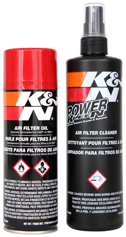

Good advice Marcin & although doing this will help, the air filters for these bikes in a stock form are paper based, cleaning them in this way has a very limited effect. Much better to replace them (if finances allow) with an after market cotton based filter so that they can actually be cleaned, re-oiled and reinstalled using a formulated cleaning kit such as this or similar.
