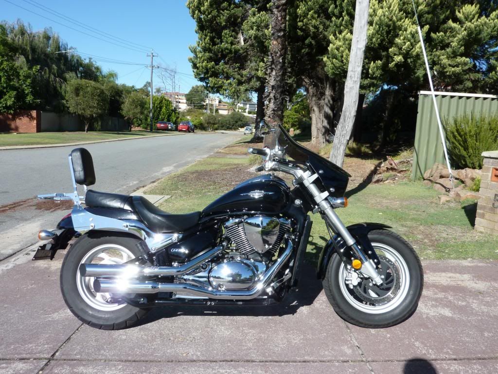

I've got the 2010 Aust. M50.
Have the Palladin removable sissy bar and rack from National Cycles. The spacing between the mounting points is slightly less than the older models so I had to elongate the front mounting slots about 15mm to make it fit. Works a treat.

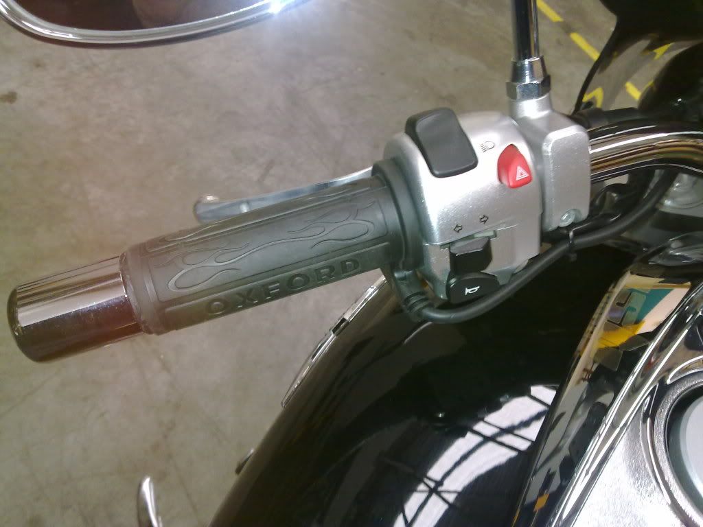

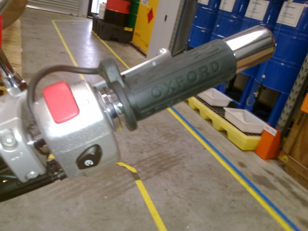

I also have the Oxford heated grips running from a switched power source so they can't be left on accidentally. Cut the screwed end off the grips to allow the original bar end weights to be used.

Your bike looks fantastic! That's exactly what I'm looking for!
Looks like the Paladin backrest is back on the table. How hard was it to modify? And how did you do it? (Drilling and filing?)

Thanks for all the info on the oxford handgrips, they're the next thing coming after I sort out this paladin backrest bit. Lately I've been warming my hands on the no. 2 cylinder on the freeways at night :P

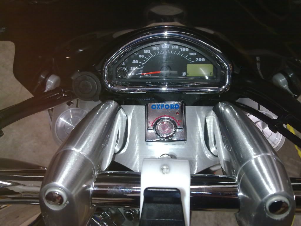

I only just noticed your 12vac accessory plug. What did you mount it to in there? I've got mine on the handlebar. Your choice seems better, out of the way and not imposing.

I just cable tied the accessory plug to the clutch and electrical cables and tucked it into the headlight cowl.

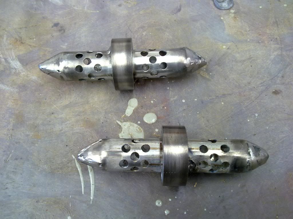

-JohnD-
PostSubject: Re: Multiple mods for M50 Boulevard (2012 Aus/Canada/Euro)   Wed May 29, 2013 11:02 am
Are they like an extra baffle to slide inside the existing to reduce the noise.
That's exactly correct Simbo. Baffle adds a little more of a tortuous exhaust gas path. Still more free flowing than stock.
Little bit of fine tuning to get the correct number of holes each side so as not too restrict gas flow too much. Noise is reduced enough to not attract undue attention but still gives a nice note. Feels like it has a bit more power than stock but that wasn't the reason for fitting them.
Originally just slipped them into the end of the supplied baffles but had to secure them with a couple of screws to stop them rattling.
Simple to remove if necessary and there is no damage to the pipes themselves.
Made from a 1" galvanised tube from hardware shop and a bit of scrap round bar from work machined to fit baffle and tube.

2 days ago I ordered some Oxford Cruiser heated handgrips. I installed them yesterday in 2.5 hours.
I can't believe I've ridden through 2 winters without them. One of them died yesterday but I discovered the pin had been pulled out from the plug socket so it was an easy fix. So far, amazing!

Hey @fasddd I am looking for any assistance you can give me about how to disable the o2 sensor.. Diagrams on the Pin23. If cutting it only disables the F1 alert or fully kills off the O2 sensor. I have a PC5 under my seat that is laying dormant as I can't tune it till I kill the O2. I have a 2013 M50 (Vz800) Philfasddd wrote:
Today I decided to remove the O2 Sensors to give complete control to the Bully unit.
It was both a nightmare and a relief!
12mm gasket plugs were easy enough to source from ebay. Bit of loctite and they were in and secure.
I taped up the electrical sockets on the bike end and have removed the O2 sensors.
I knew I would have an FI light issue but there is an instruction printoff floating online telling you to cut Pin 23 on the ECU main socket.
It is noted that it would be a black and brown wire.
Followed the diagram, snipped the wire. Reconnected everything for the test run.
FI warning, ODO flashing. wouldn't start. Turned over but no life in it.
After much investigation I found a thread that said the instructions were incorrect, that it was Pin 23, but the diagram was from the wrong perspective, and I had actually cut Pin 6.
So I reconnected the wire using a Splice tap and started her up. She ran fine but I still had the FI light.
Looking at this new diagram I determined the new wire, and snipped it.
Only to find it didn't do anything. bike still ran, but still had the FI light on.
Further scrutinizing had shown the diagram was not for the ECU socket, but for the ECU (so everything was horizontally inverted)
After reconnecting the second snipped wire, I cut a third.
This time it was successful. Noticed more response from the Bully. Very happy so far!
