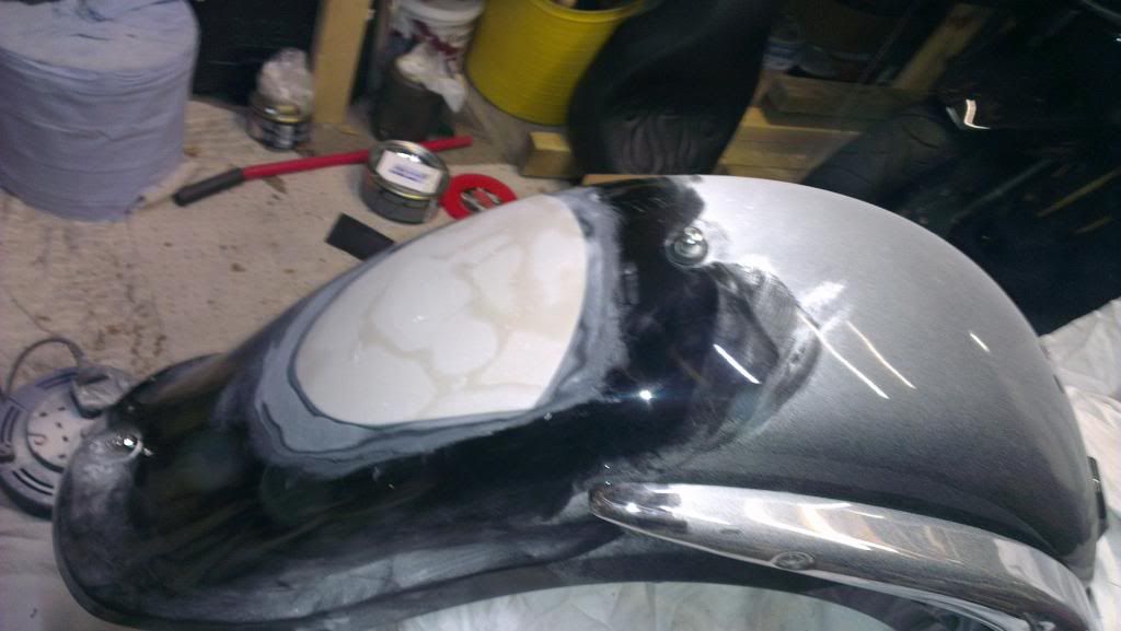

Today I started removing parts from my bike to start the process of removing the rear light and positioning an different one elsewhere, First of all I took the light, fender and rails off to get more of an idea how it all goes together and how I'd fill the big fuck off crater behind the rear light?
Then I packed fibre glass in the holes from both sides so it sandwiches the fender in between to stop it dropping out,
Then I drilled about twenty 3mm holes around the edge of the recess for the light and other various points, so the filler squeezes through the holes to create a key, (sorry no photo)
Next, I built it up with 2 pack filler slightly proud of the crater, Then got the palm sander on it to get the profile of the fender,
Far from finished yet, but I'm onto the fine filling stage and hand sanding to make sure it feels ok. I'll update as and when I do some more.

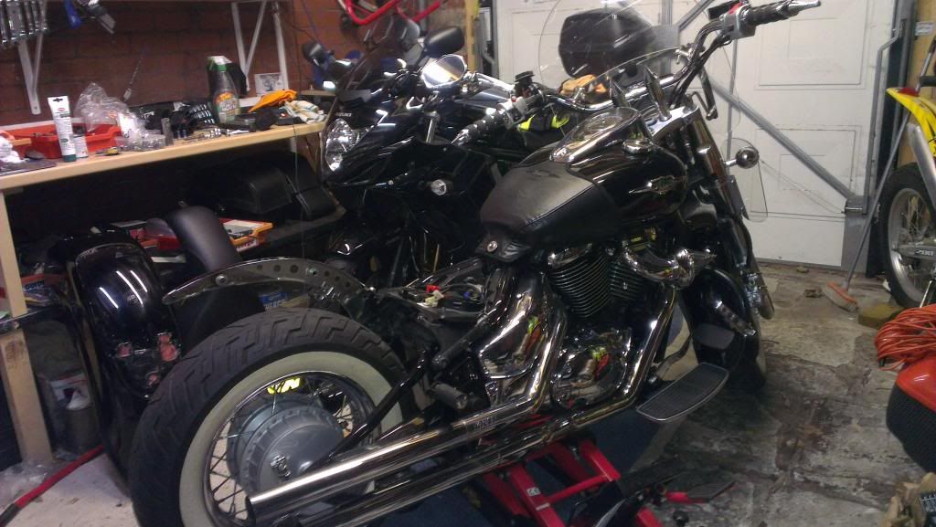

PostSubject: Re: Clean Rear Fender .......... 2009 Suzuki C800   Sun Oct 20, 2013 6:37 pm
top pic Sim wow go bobber Sim
PostSubject: Re: Clean Rear Fender .......... 2009 Suzuki C800   Sun Oct 20, 2013 6:44 pm
I did try the stock rider seat on while I had it stripped down and thought Hmmmmm  But then I got the frown from Jo and quickly forgot that idea

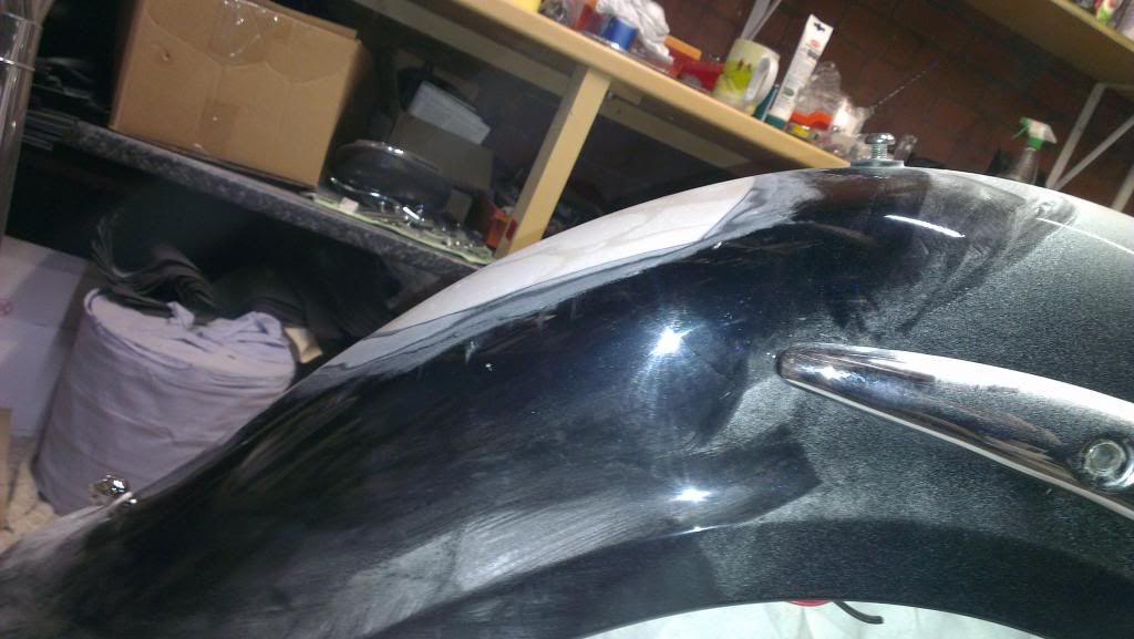

PostSubject: Re: Clean Rear Fender .......... 2009 Suzuki C800   Sat Oct 26, 2013 9:06 pm
Nearly there Very Happy
PostSubject: Re: Clean Rear Fender .......... 2009 Suzuki C800   Sat Oct 26, 2013 9:30 pm
You can see from the way the light hits it in the photo, you've nailed that curve 100%. Great work Sim!!

PostSubject: Re: Clean Rear Fender .......... 2009 Suzuki C800   Sun Nov 03, 2013 8:06 pm
Getting there! still not finished yet though lol Lights above? would they work with windscreen tint stuck over the face to black them out? I've ordered a couple for trying :what1:
PostSubject: Re: Clean Rear Fender .......... 2009 Suzuki C800   Sun Nov 03, 2013 8:10 pm
Lovely...
A lot of sanding to go though...orange peel galore so far affraid

PostSubject: Re: Clean Rear Fender .......... 2009 Suzuki C800   Sun Nov 03, 2013 8:32 pm
sanding and lacquer will sort that plus the light it's under is making it look worse (stand out more) me think's a great job so far great shine to it my prediction it will look blooming brilliant when finished   keep up the good work mate

Cheers guys   Marcin, I was hoping to get 6 coats of lacquer on today, Then flat it down smooth with no orange peel before giving it another 2 coats and then use rubbing compound and a polisher to bring it to a nice finish, I only managed 3 due to fatherly duties, So I'll flat it down again before getting another 3 on, then flat it down before finishing with the final 2, What grade would you recommend sanding between coats? 800 or 1200? Also, would you use a lubricant in the water, or just water for flatting down between coats? Cheers.
PostSubject: Re: Clean Rear Fender .......... 2009 Suzuki C800   Sun Nov 03, 2013 10:25 pm
By my reckoning I'd do no lower than 1200.
1500-2000 for the final polish due to minimal amount to be taken off. I guess it depends on the lacquer as well and if you laid it thick or just misting over.
With so many layers I'd probably try to lay a wet one on to see if it will level out on its own before going in with sanding.
What lacquer are you using? Normally you work to a specific timeframe with these ie layer every 15 minutes or so. Does your allow you to leave it overnight? I'm guessing it does.
Please take my pointers with a pinch of salt, I'm no pro :)
PostSubject: Re: Clean Rear Fender .......... 2009 Suzuki C800   Sun Nov 03, 2013 10:46 pm
I was thinking a very careful 800 lubricated next, to get flat again, then 3 coats with a 15/25 mins between coats, each coat blends into the last, forming one so to speak, then a flat down with a very careful 1000 before the final 2 coats, then flat down with a 1200 before buffing and polishing 4 days later? I don't fancy wet coating it really, I'd rather just spend time on the last two coats bringing it up nice without the risk of a run/sag to contend with  Pro? Nor am I mate lol I've been at it about 30 hours already! all good fun though
