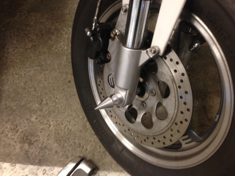

Decided to make some spikes and mount them on the front wheel shaft.
After a lot of thinking on how those things are mounted and stick to the shaft, i actually went to the garage to see if i could get some good ideas. It i would have done that from the start i would have noticed that the front wheel shaft has a hole straight through it.  That would have saved me quite a bit of time to think about something else. Wink
So the parts i need. 2 cones  and a shaft with threads on each end to..... Said and done.
Ordered a bit of 30mm aluminum shaft and some 10mm aluminum shaft.
Took the parts to my work and borrowed the turning machine for a few hours. And this is the result.
The first pair i made. was a bit to short and not as pointy as i wanted them. but i used them as a test to mount things in place and see that i have been thinking straight.
This is the ones im gonna use. about 15mm longer than the first ones, pollished and waxed.

Took me a while to figure out how to mount them. But the job was quite easy and fun when it came to the execution Wink
Am a bit disapointed of the surface on the cones, but thats the turning machine that aint 100% centered so its not possible to get a better outcome on that machine

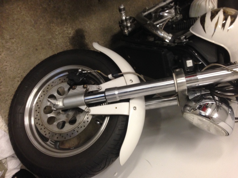

Got them mounted yesterday...
Had to do some modifications to the axel that im using to tighten the spikes since one end of the wheel shaft have a 8mm hole and not 10mm thats in the other end.
im really happy with the results :)
