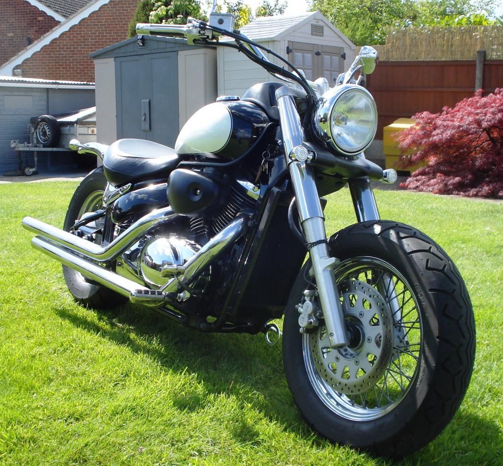

So this is where I'm up to now.  I was going to get a front mudguard made by the same people, but I've managed to pick up a genuine used original at a damn good price off ebay, so I'll cut & spray that one - mainly as I don't know when the fabricators can fit me in again - although, I do like the naked front end.  I'm going to change the number plate lights, going for something more old school.  Completely de-badged now - the only Suzuki reference is on the VIN plate.  I want to cut the exhaust so it finishes level around the exhaust bracket - not sure how that's going to screw up the carburation though - probably a Winter project.  I'll have the wheels powder coated black at some point - the fabricators reckon it's a piece of cake - they can do them in house - then whitewall the tyres " />
Nice thing about this mod is that it can be changed back to standard in about an hour or so.  I probably went over the top with the indicators - they cost more than the mudguard cost me to have made !!  I could have done it cheaper by having brackets made to fit into the chrome rails & using the original lollipops, but these do look the dogs.  Although, compared to what I've spent on the Katana, this has cost peanuts - if I'd recycled the original indicators, it would have cost less than £200.  (Which is less than what it's costing me to have a broken tooth crowned !!)
I know it ain't going to be to many peoples taste, but it's pretty much what I had in mind when I started looking for the bike - that back tire is too fat to be hidden.  Plus, shedding the back guard & lights loses almost 10 kg!! Bonus.

Just fitted the front mudguard (£65 off ebay - cut down & sprayed by my cous) - I did like the no front guard look, but practicality won out.
Decided to take a run down to Bassetts Pole a couple of weeks back. Not been down for three years & the weather looked good at 5pm. Got onto the 42 at Ashby & the heavens opened. So spent an hour at Maccies at junction 11 then came home.
I did learn three interesting things though
1/ Its a piece of piss to scrape the pegs with "enthusiastic" riding
2/ The bike defo needs the front mudguard. I expected the rain to go into the radiator but you actually get a plume of water shooting horizontally in front of you so you're riding into it !! Which leads to fact 3
3/ The Buff covering your nose & mouth becomes saturated, at which point it's impossible to breath - it's like having a wet flannel pushed into your face at 70 mph. I can imagine that's what it feels like to be waterboarded.
So that’s why the front guard is back on !
She’s just had a service & MOT (passed but advisories on the rear light set-up – why they can be legal on Harleys but not if you fit them yourself is beyond me).  The carb was well out & it runs like a dream now – hoping fuel consumption goes up from 33 !!
I reckon the whole lot, including indicators & side mount plate has come in at under £500
That’s enough for this year (said that before), but making plans for winter.  Powder coat the wheels, whitewall the tyres (recommendations on that please – Marcin, I may pop down one day & have a look at yours !! ), & chop the pipes down, poss with a slash cut.
Thanks for the encouraging comments & tips from you all – I expected some criticism, but everyone’s been very positive – thanks.
And this how it started - best 500 I've spent in a long time !!

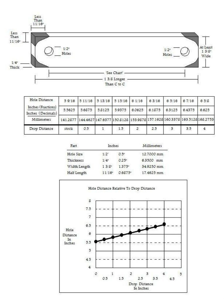

Here is the scale for lowering bones on an Intruder.
The scale shows that there is minimal drop to the under frame of the Intruder, most of the drop will be towards the very rear of the mudguard. The lowering will make a negligible drop towards the front of the frame or more to the point where the front pegs are. If anyone notices they are scraping the front pegs more they must have a computer in there heads that is fed by another one fitted on the bike to give them precise lean acute angles, it really would be so negligible to the front. To go from the stock position to an increased drop of 4", the bones have the length of position between the holes only increased by 1.065".
PostSubject: Re: Stripped down look wanted, 2001 VL800. (Now Done)   Fri Jul 04, 2014 5:58 pm
Half an inch drop at the rear of the foot board (the nut) with a 2" drop at the rear.

Thanks for the chart Dave - it makes it more understandable.  A 2" drop on mine would put the mudguard almost touching the tyre - & that's without my 15 stone sat on it !!!  I reckon the fabricators who made the guard would be able to knock up one which drops it by an inch, maybe inch & half.
Again, thanks for that

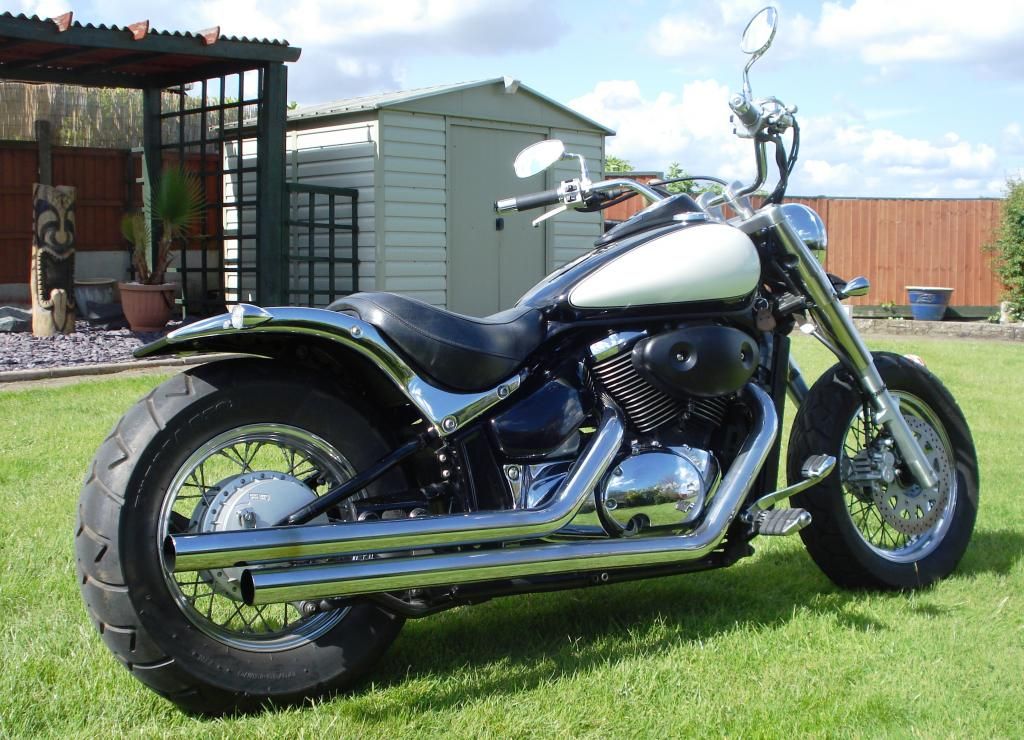

Just in case anyone's interested - this is how it's turned out BOBBED
