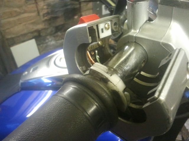

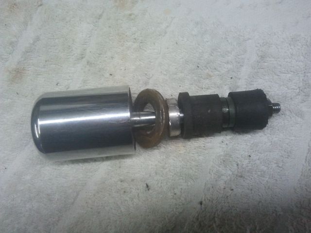

PostSubject: Re: Changing Handlebars '13 plate VZ800   Wed Feb 19, 2014 2:35 pm
The throttle side is the hard one of the two,things to remember are first do not take the bar end wieght screw all the way out,on both sides,loosen them and in the process pull the bar end wieght until it comes out do this gradually or you will loose the ends in the bars.You may need something like a knife to slip between the grip and the bar on the clutch side to loosen the grip this is normal.When taking the throttle linkage off take your time and take a photo if need be how the cables disconnect so you know which way they go back on,there are two one opens the throttle the other returns it.These jobs are always daughnting to start with,but once done the first time will be easy.The hole you see in the throttle side on the bar is to locate your linkage back up correctly,if you get differnt bars this will not be in the right place so will have to drill it to suit.

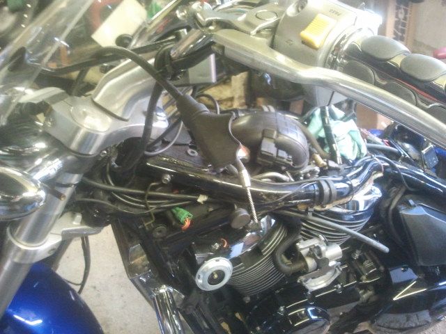

If you are having trouble with the length of the clutch cable then re route it as photo,remembering to disconnect from the lever end and not the engine end,placing the cable up along the cylander then in front of the tree and back into the lever.Hope this helps,give yourself a day to work on it,there may be slight differences but the theory is more or less the same.
