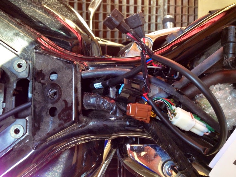

| Herre are some pics. Removing the tank bracket made it easy to route the wires underneath. | |
