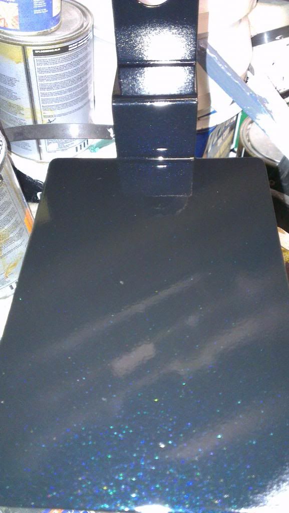

Hi Skidalot, If your M800 is the same colour as my C800? The paint code is YAY and it's called Pearl Nebular Black, If you look in your service book it has the colour name and code there, This is the colour of my bike,It's black with a blue fleck that only stands out in the sunshine.

Ok so it is a base coat and needs a clear coat afterwards.
How well does the paint match the original ?

Yes It's a base coat (after primer) and needs a clear coat over the top, I used the one from the first link and it was a very good match to the original colour and the amount of blue flake was very good compared to the original paint on 'my' bike, I've never used the one from the second link, but from other peoples reviews the colour is good but it doesn't have the same amount of blue fleck as the factory paint, I've spoken to various local paint suppliers and paint manufacturers, and their opinion is that they can match the colour without problem, it's the amount of blue fleck they have difficulty with? I suppose it's down to each batch of paint Suzuki use on the production line at any one time.
