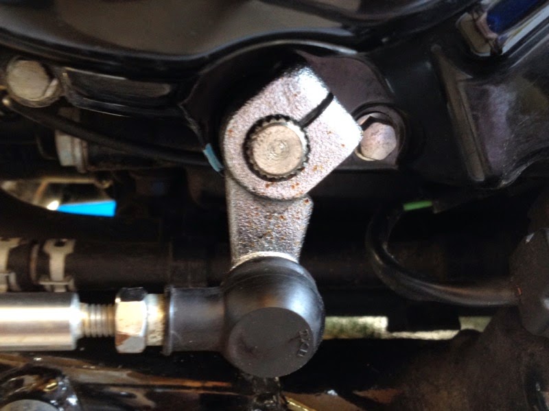

His gear shifter was much smoother and was much higher. I have now adjusted the gear linkage so that both the gear shifter rod crank is vertical, and the foot gear shifter pedal crank is vertical, this brought the pedal a bit higher and may help better return the shifter after changing gears, and eliminate missing gears some times.

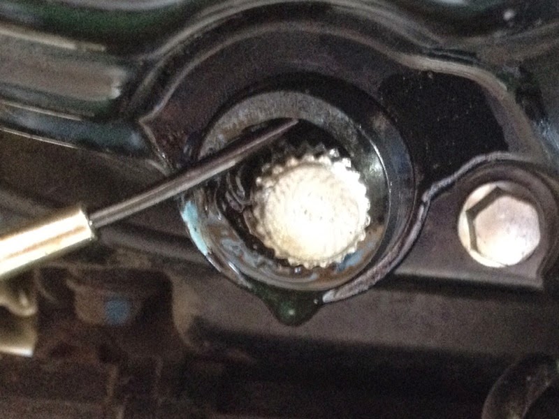

But in trying to get my shifter more smooth, I inspected the shifter rod seal and it looked dry and a bit cracked.
I tried to spray it with WD40 and oil, but the shifter rod still feels sort of crunchy when I rotate it, like there is sand in the bearing.
I have googled gear shifter issues, and in some cases the seal needs replacement, and I think that is a good idea as it looks dry and cracked, but do you think I need to remove the shifter rod to clean it and regrease it ?
And what is the easiest way to remove the shifter rod ?

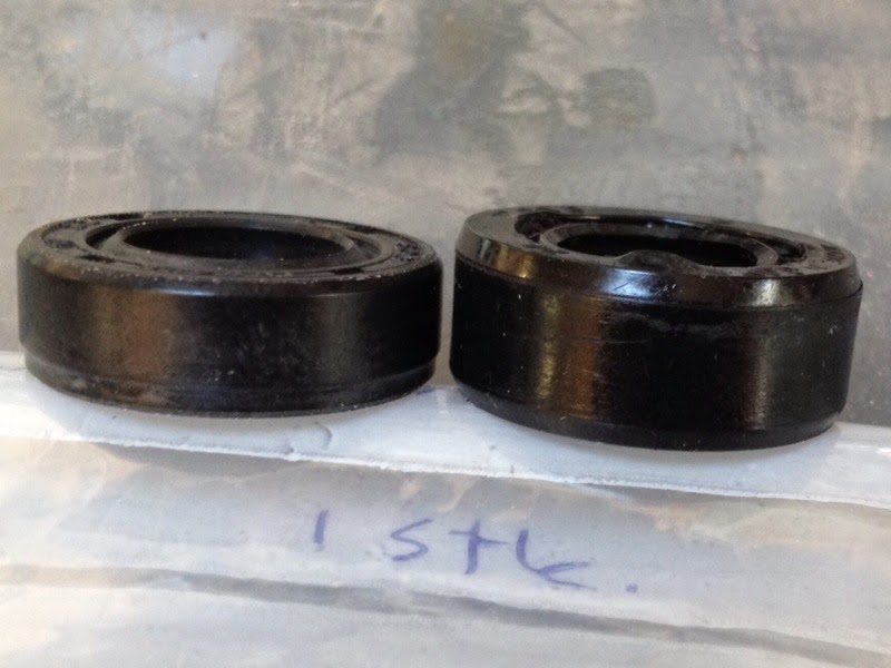

I changed the oil seal, oil and oil filter today. It helped a bit, but there is still a little grinding feeling in the first small turning motion of the gear shifter shaft.
I could only get a 22x12x7mm oil seal, and the original is 22x12x9mm, but it does not matter as it just sits a bit deeper in the housing.
There is plenty of play between the shifter shaft and the housing, to allow oil to lubricate it, and I don't think it can rust in there.
But as it helped with the new oil, it is most likely just the return spring grinding a bit on the pin holding it.
Everything is working fine and the shifting is good, so I won't do anything about this.
