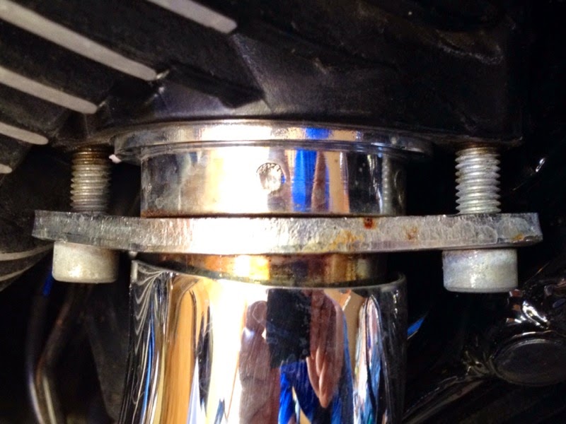

Just looked again and that bottom photo shows a bent flange, dont think thats right. Are they used pipe rather than new because if they are 2nd hand the previous owner has possibly over tightened them causing that bend. Exhaust seal would probably be the only answer, maybe someone else knows more? Just bear with the guys, you will get a proper response, just depends on when they get a chance to look properly at all the threads/posts

I'd imagine if someone tightened them enough to bend that flange, the threads would strip.
They're v&h cruzers not stock. If that is the cause I suppose I could try and reshape them but they are very strong
PostSubject: Re: Vance and Hines Cruzers popping on decel carbed vl800    Fri Jun 13, 2014 6:43 pm
That bottom picture shows a distorted header clamp.

As you can see my Cruzers flange is also a bit distorted, but no leaks.

I can feel air puffing in that location. Yours are nowhere near as bad as mine. I don't think they are removable either. Could try and figure out a way to bend them back but that would weaken them.

Have just been looking at your photos and the flange is well bent, looking at the clearance around the head it looks like it would be no problem to fit studs with nuts instead of of Allen bolts, this would be stronger and less liable to damage the threads in the head when tightening them up, also you could probably fit another flange that has been cut in half as this would spread the load and help prevent or minimise distortion, will have a look at Mr Intruders exhaust and get back to you, regards Doc Cox.

Im going to get the flanges flattened. Two new gaskets, new studs, bolts and sealer then. If that doesnt work i give up!

Fixed it. Had the flanges hammered flat, got two new gaskets and its cured the problem.
Bike runs a lot cooler and seems snappier too. Sorry for the two threads it was driving me nuts.
Get the odd quiet pop on overrun but its minimal. Before it went off like a shotgun at times!

Pleased it was so easily fixed, the photo said it all for me. Well pleased for you, simple shite can at time cause a big headache.

EazyDuz
PostSubject: Re: Vance and Hines Cruzers popping on decel carbed vl800    Sun Jun 22, 2014 5:21 pm
Flattened flange and new gaskets, no sealant. I have been running redEx through it too if that would make a difference?
The gaskets aren't OEM though, they're from 'gasketsman' on eBay. Still, wouldn't have thought they'd lose a seal if untouched
EazyDuz
PostSubject: Re: Vance and Hines Cruzers popping on decel carbed vl800    Sun Jul 13, 2014 2:36 pm
It has got worse still.
Guess I'll need to fork out £20 for the OEM gaskets and try again. All aftermarket ones ivr tried are very poor quality. What a bore! It makes the bike run way too hot.
