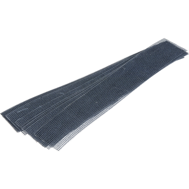

And I thought cleaning the fins & barrels was tedious.  I'm using a combination of 400 grit emery cloth on a roll & these things to finish them off Luster Lace Strips.
Results are good - but it's a long term project, not just an evening with a coffee & the radio.  If anyone has any other ideas, please toss them out whilst I still have finger ends left !!

No other tested idea's from me Dave Sorry, Just a thought though? Plumbers use a little strip of flexible fibreglass mesh bonded with something or other? that gets a nice bright finish on copper and seems to last ages, this stuff, not sure what grades it comes in though?
http://www.toolstation.com/shop/Hand+Tools/d10/Plumbers+Tools/sd210/Abrasive+Clean+Up+Strip/p85391

Hiya Sim.  I'd looked at something similar, but I'd already tried some of my own 180 emery & it left marks which I had to wet & dry off.  The 400 grit is enough to take the surface crap off without damaging the surface.  25 metres on a roll cost me just over a fiver.
