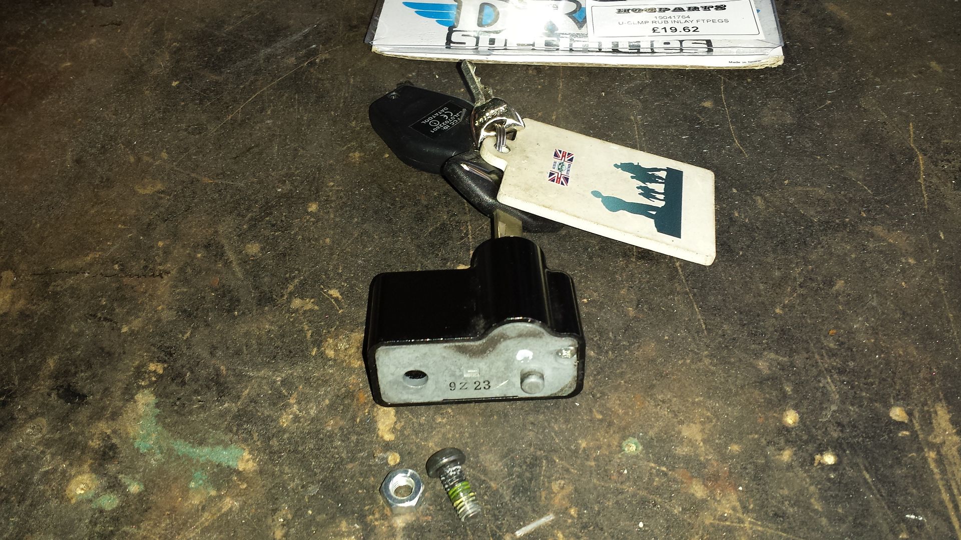

Here is the helmet lock from the rear, you need the key in it to remove it. As you can see there is on lug to hold it secure and a hole for the bolt to go through, that also holds it.
Moved the Helmet Lock to Front Mud-Guard 20150418_144502_zpsipganvxw

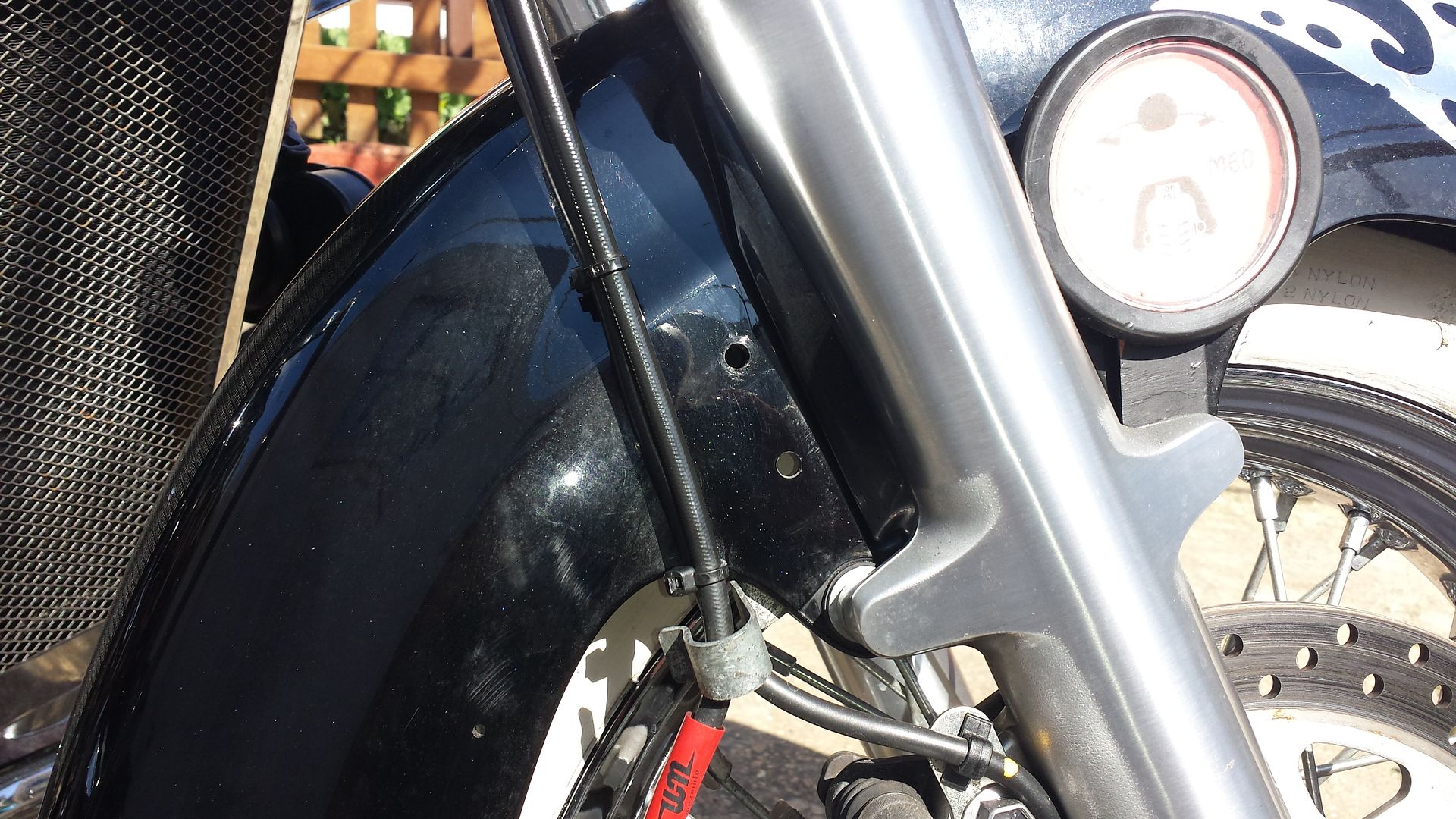

Here are the 2 holes drilled, that are need to relocate it where you want it. I put it on the front guard.
Moved the Helmet Lock to Front Mud-Guard 20150418_144536_zpsh3r26o9b

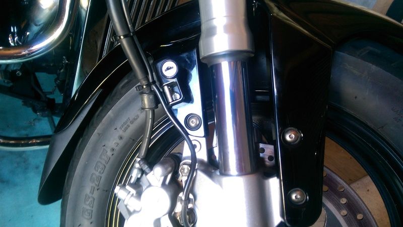

Here it is installed, much easier to use.
Moved the Helmet Lock to Front Mud-Guard 20150418_145447_zpssgvc7rln
I know some will say oh that is not as safe as where it was but it is safer for me. Firstly the guard there is very thick and strong. Secondly I can use it now, where it was I couldn't. Also I will be reinforcing the rear of the guard with sheet metal where it as at a later date.
I am now happier and it was simples, took 20 minutes to do.

In the top picture I can see you have bought something from Hogparts for £19.62p. Cmon davey spill the beans and tell us what it is. Seems like the old davey is finally back, 2 mods in one day, reminds me of the days when you had so many mods in your signature that they took up half a page when you posted  Moved the Helmet Lock to Front Mud-Guard 1993399755
Only some more highway pegs to replace the ones damaged when I had my RTA 20 moths ago. Nothing to adventurous.

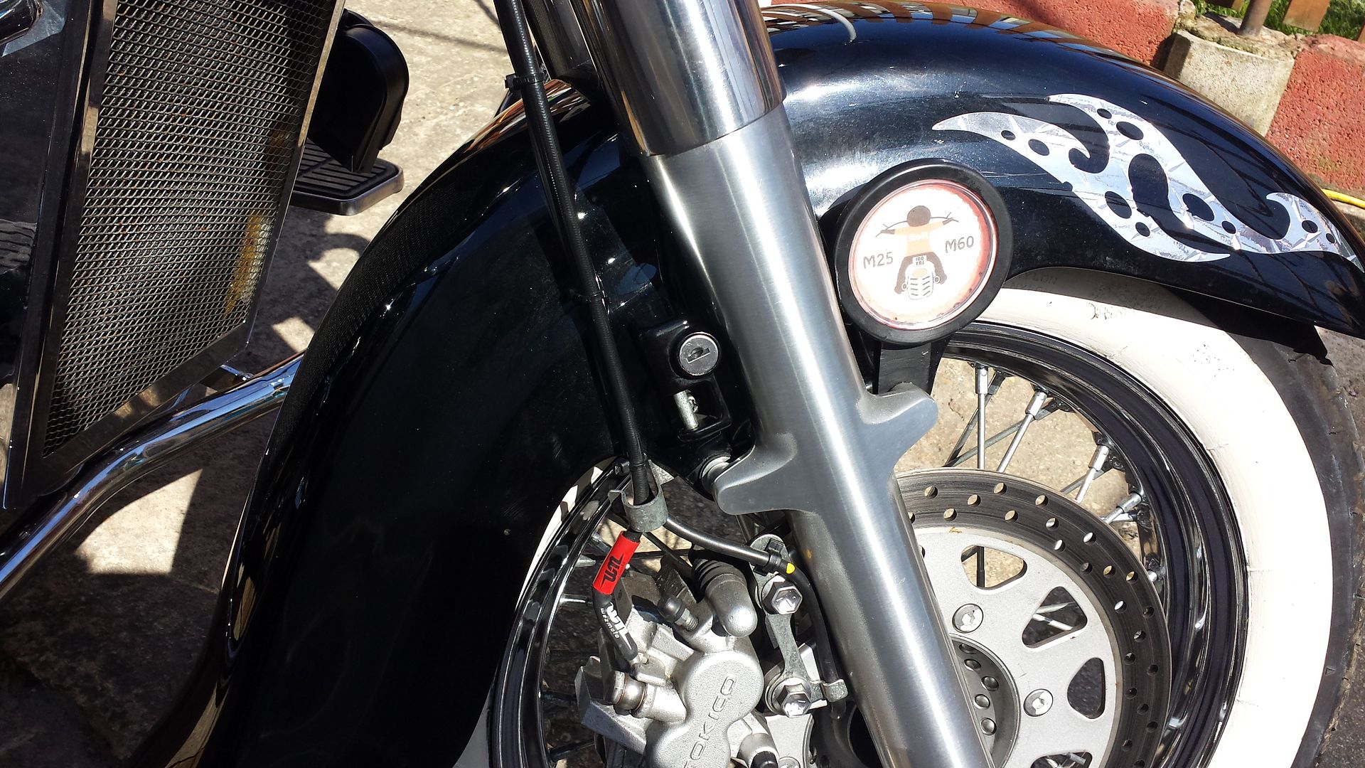

Hi guys
Done my M800 this morning, took the mudguard off the bike because i would have drilled the tyre Moved the Helmet Lock to Front Mud-Guard 474255   thanks Dave i have now got a helmet lock that i can use, I put some big washers on the back to provide some extra support and some blue loctite on the bolt, nice easy mod  Moved the Helmet Lock to Front Mud-Guard 1218875559
Moved the Helmet Lock to Front Mud-Guard <a href=Moved the Helmet Lock to Front Mud-Guard IMAG0729_zpsohnqwbaq" />
Moved the Helmet Lock to Front Mud-Guard <a href=Moved the Helmet Lock to Front Mud-Guard IMAG0728_zpshjlqtkpm" />
Andy   Moved the Helmet Lock to Front Mud-Guard 2650920580

Finished my post 2010 M50/M800 helmet lock conversion.  I put the lock on the fairing to the front of the suspension tube where it is really accessible.  Also put it on with the lock pin uppermost and the closed in portion of the lock to the front to reduce water being blown into the lock itself.  That way, when the lock is open the small part of the lock pin sticks up and you can put your D-ring over it and it will hang there while you close the lock.
I had considered putting the lock on the trunk box mounting bracket I've just fixed to my bike.  Wisely I held the helmet and D-ring in place where I was thinking of putting the lock and there just wasn't enough space to get the helmet close enough to the lock because of the saddlebag below and trunk box above.
Now the lock is very accessible, hangs the helmet clear of the ground, and isn't too obtrusive.

Here's yet another take on this excellent idea....
First a word about removing the lock.... Here's a close up of the original bolt:
Moved the Helmet Lock to Front Mud-Guard Image_5
So you need one of these to remove it... Moved the Helmet Lock to Front Mud-Guard 038902004369lg
I didn't have one, but toolstation sell this nifty set for less than four quid...
Moved the Helmet Lock to Front Mud-Guard 92461
Once you've decided where to relocate the lock, you'll need to drill 2 holes - one for the bolt and one for a lug on the back of the lock.
As I like to stick my lid shiny side up on the sissy bar (in case it rains) I put the lock on the sissy bar luggage rack...
Moved the Helmet Lock to Front Mud-Guard Image_6
And if wanted, I could use it to secure any luggage with a looped cable.
Moved the Helmet Lock to Front Mud-Guard 3005623951 To dave, for having the brainwave in the first place wagg

Looking at the photo now, I may flip it the other way up, might look more aesthetically pleasing.........
Yes, that's better... sssmily
