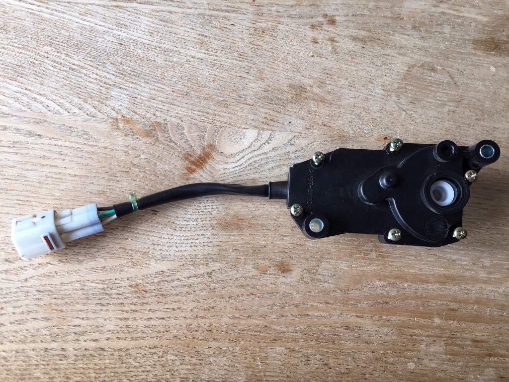

I decided to check the STVA for damage by pulling it from the throttle body, and taking it apart.
To do this I had to remove the secondary throttle position sensor, and that is a bitch to put back in, but more on that later.
REMEMBER to mark the position of the STPS on the STVA, otherwise you will have to calibrate it afterwards.
Bike is idling at  very high rpm. IMG_0123
Bike is idling at  very high rpm. IMG_0124
We are in luck with the STVA, as it is kept together with screws and not rivets.
Bike is idling at  very high rpm. IMG_0115
Bike is idling at  very high rpm. IMG_0118
Another lucky thing is that it used two metal gears instead of plastic, and it was in mint condition.
Bike is idling at  very high rpm. IMG_0121
Now came the hard part, installing it back in.
It is not possible to install the STVA with the STPS in place, and there is not enough room to put the screw holding it in place, after the STVA has been installed.
After I spend about 30min on this, I decided to loosen the complete throttle body.
Success, it moved the whole assembly up, allowing room to put the screw in.
Everything is back together and the bike is perfect again.
