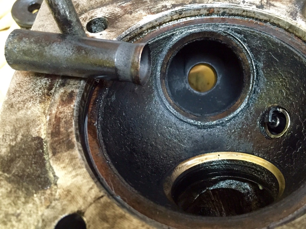

I have btw gotten another Dnepr, as I realized the MT9 will take some time to get ready to run.
This is a 1980 Dnepr MT10-36, so it is a classic bike too, as thus very cheap registretion and insurance.
I had to fix the electrics and borrow the heads from the MT9, as one head had a big hole at a broken fin, and the other had a loose exhaust valve guide.
After putting some other carburators on it, and replacing oils and brakes, it runs and I just need to punch in the VIN in the hack to be able to register it with and without the hack.

That valve doesn't look like it's been seating very well  Old Russian iron  852880 are they easy to work on? I've read that they're a bike you could strip and rebuild at the roadside if need be.
It ran even though the valve guide nearly fell out by itself, but the was some blue smoke on the side  Old Russian iron  2740622253
And yes it is very easy and great fun to work on, but the metal quality is terrible on nearly all parts.
I plan on doing a complete engine rebuild during the winter, to have a reliable engine to take on longer trips.

But nothing a little polishing of both the valve and the guide with sandpaper can't fix.
Old Russian iron  IMG_1458
Old Russian iron  IMG_1459

they run on mm clearance Kim not microns lol!
