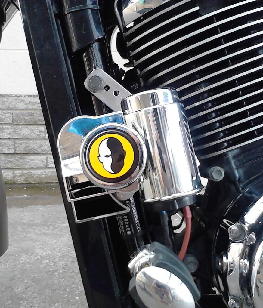

Mine arrived yesterday, any pointers on where to fit it!!  I know the norm is the top frame bolt on the left side but I cant due to massive engine guard any other options before I start making plates up. thanks
PostSubject: Re: Fitting 139db horn   Tue Oct 20, 2015 5:29 pm
I'd accept that you're going to need to knock up a basic bracket to fit where you said Justin, - unfortunately, it's the best location for routing the cables & picking up a feed from the existing horn.  All you need is a piece of flat steel about 1" x 3"
PostSubject: Re: Fitting 139db horn   Tue Oct 20, 2015 5:53 pm
Thanks Dave, that's what I thought. Did you run the neg back to the battery or just used a o connector and put it behind the screw going into the frame? the existing horns didn't have a neg terminal the connection to the frame acted as the earth.
PostSubject: Re: Fitting 139db horn   Tue Oct 20, 2015 6:05 pm
I ran it directly to the battery as mine came with heavy gauge wire
