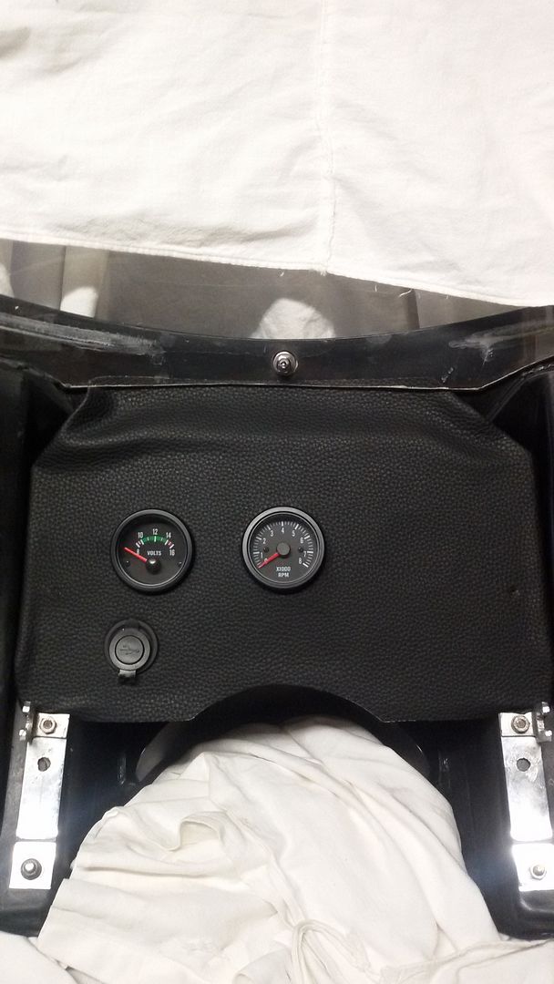

I've been busy over the last couple of days working on the dash panel again. All wiring was completed yesterday having taken delivery of the tachometer & voltmeter. I am still waiting for the analogue clock which will be going in the hole on the right of the panel when I get it.
Below us a very short video of the items which are fitted,  working. It's not pretty as it still needs to be covered in vinyl fabric but that will be taken care of in the next few days.
 I'm very impressed with how the voltmeter looks, less so with the tacho but it does the job and the needle travels nice & smoothly with no bouncing as has been reported with some tachos on this site.
The little USB charger socket will come in handy for phone / iPod and the like, particularly when I get a pocket fitted on the dash to hold things of this nature.

PostSubject: Re: Dash Panel   Sun Dec 13, 2015 2:10 pm
Progress report .....
Got the tacho & voltmeter installed plus vinyl covering glued on to the panel. As I'd lots of vinyl material left  I've decided to cover the internals of the hanguard part of the fairing to tidy it up as it was a bit rough. Just awaiting some edge trim now to complete the dash panel itself and I've also ordered some to install around the fairing itself to tidy the edges up.

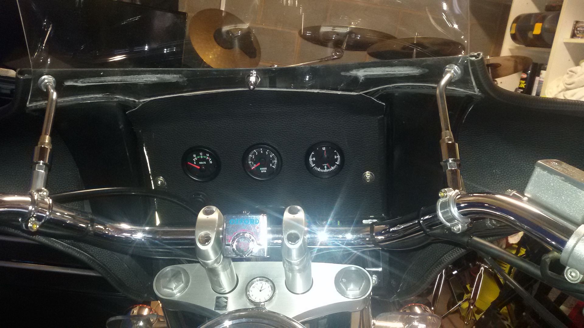

Update No 2 ... almost done now. Clock is ordered and due for delivery tomorrow and as it's wired and ready will be simple to fit. Here's the clock I've ordered - a little pricey but not bad for a VDO clock and its the best fit for my needs that I can find
http://www.ebay.co.uk/itm/391237690017?_trksid=p2057872.m2749.l2649&ssPageName=STRK%3AMEBIDX%3AIT

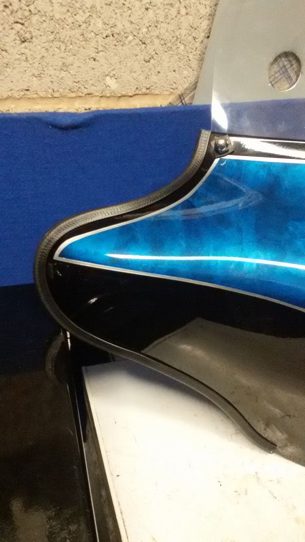

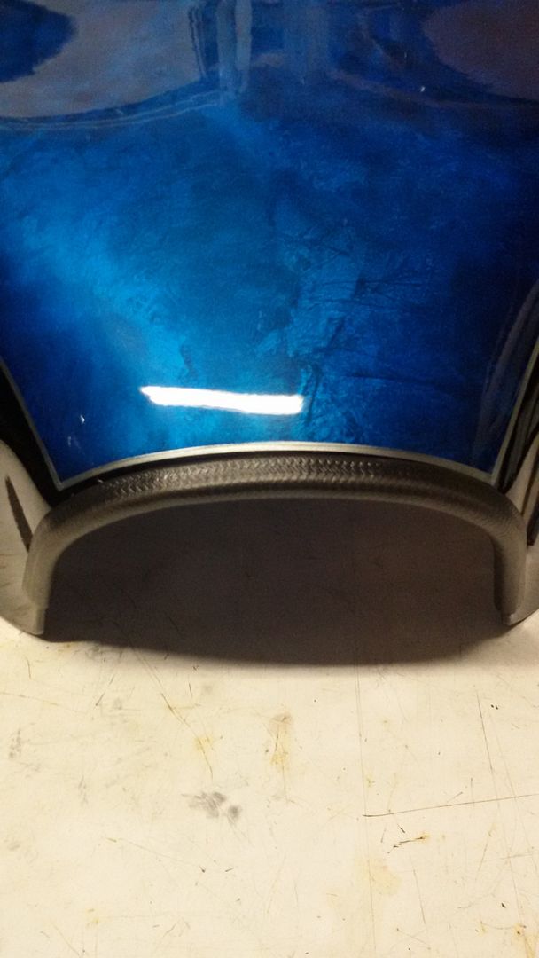

Edge trim is installed on both the panel and the fairing edges but I'm unsure what to do with the top of the fabric to get it to look right.

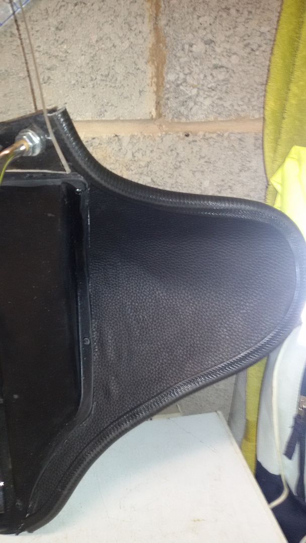

I need the fabric to join to the fairing to stop light from the instrument backlights bleeding out through the gaps between the panel and the fairing. This in itself is OK but I can't figure out how to get it to look neat in the top corners so may need to put my thinking cap on unless anyone has any suggestions.
Should all be done for the weekend however I decide to do it so I'll post some more pics up then.
What a project this has been ... I expected it to be quite simple once I got working on it but its been the small details which have taken up most of the time. A full day to wire it, a full day to cut / cover the panel and several days ( weeks it seems ) waiting for delivery of gauges, trim and other bits and pieces. Hopefully it'll all look good when its done !
Fairing trim - exterior view
 Fairing trim - around headlight recess
Fairing trim - interior view

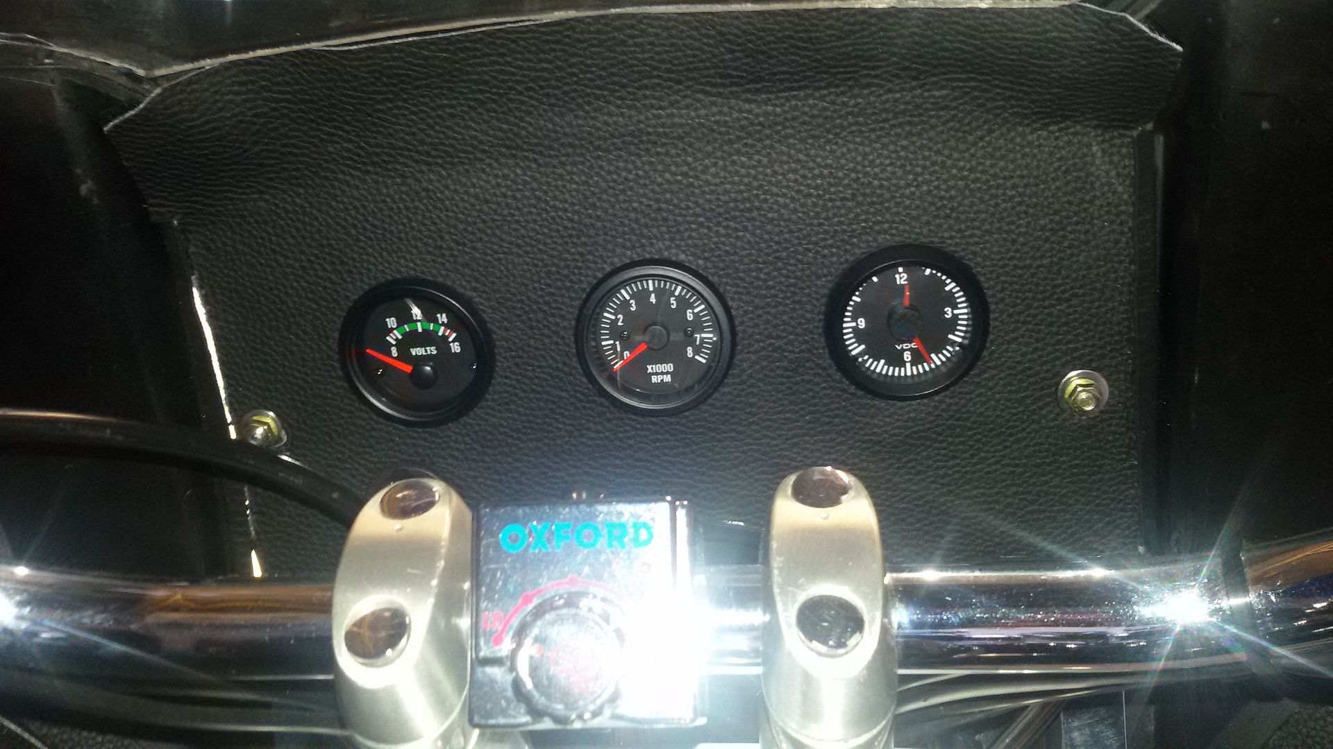

Edge trim and Dash panel - minus clock .... (white edges around panel have been tidied up since photo was taken )
You can see where the clock will be going on the right hand side as the hole is cut out behind the fabric, just got to trim the fabric away when I fit it.

So, clock came today ..... here's the fairing panel installed & although you can't tell from this, fully working.
Still needs some tidying in places but I've spent enough time on it for just now - I'll tidy it up a bit later. For now, everything works although one thing I'm not particularly happy with is that all the backlights on all 3 instruments are different brightnesses. Not a great deal I can do about it as the tacho and clock backlights are integral so i can't swap the bulbs for dimmer ones. The voltmeter shines like bloody Polaris when its lit whilst the other two are much dimmer, the clock being dimmer than the tacho. Oh well, not much I can do about it now

PostSubject: Re: Dash Panel   Fri Dec 18, 2015 5:05 pm
Tbat looks good Mick ...worth all the effort
Could you put a bit of 'Smokey ' film over the bright ones ?
Old Luner
Old Luner
PostSubject: Re: Dash Panel   Fri Dec 18, 2015 5:07 pm
I've always liked that screen Mick, it's even nicer now,.
Would a piece of screen tinting film dim that bright clock down a bit ?
