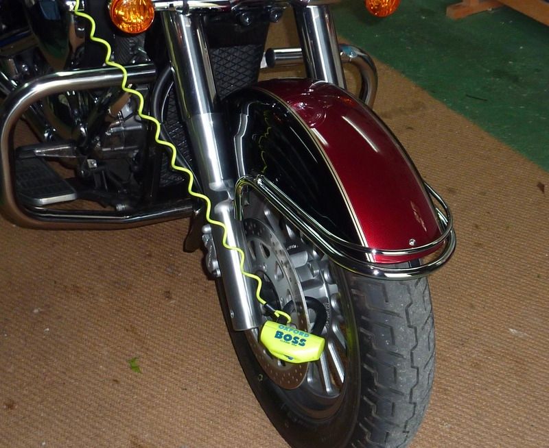

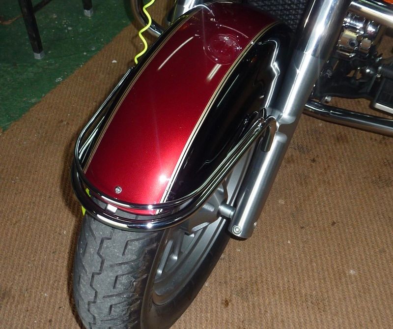

| I bought and fitted a bit more bling. Highway Hawk 603-015 for C800 2009 - on. Notes: you have to drill a 4.8mm hole in the mudguard and need to measure carefully. The stainless bolt supplied was too short ( that mudguard is very thick) so I had to fit a longer one, a flat-domed internal-hex in stainless with a stainless nylock underneath. | |
