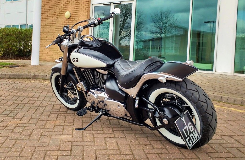

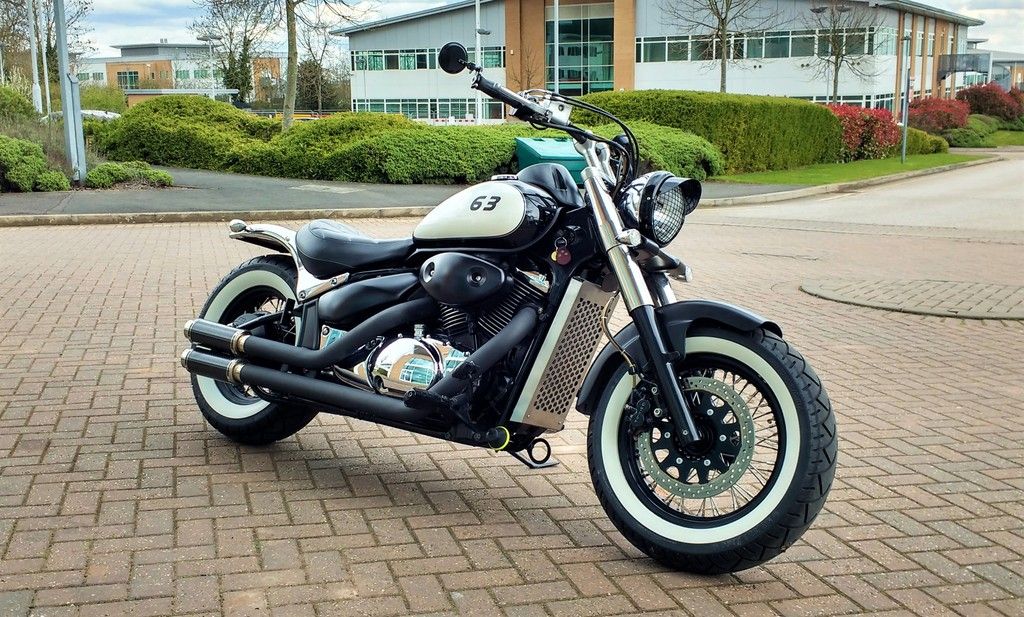

| Front or rear ? You looking for huggers or high? I cut down the original front & had a local fabricator knock up the rear [img][img:bfed]https://i758.photobucket.com/albums/xx225/katsd11/IMG_20160409_144115037_HDR_zp[url=https://s758.photobucket.com/user/katsd11/media/IMG_20160409_144115037_HDR_zpsqzoxxu19.jpg.html] [/img] [img] [/img] If you go for a hugger, you're really going to have to fit a sprung saddle - they look the dogz, but aren't the most comfy. Using the original frame supprts means you can keep the stock seat [/url][/img] | |

| Thats a really nice piece of work I'm impressed. I'm a fabricator myself so this gives me food thought. its nice to see that front end just cut looks good. I love that exhaust system was that bought or fabricated | |

| If you're cutting the front end down, best play around with some masking tape to get your lines visually pleasing. The rear has the return fitted with captive nuts to fix the seat to & the end is rolled under rather than a sharp edge. The fabricator told me that was a bit of a long winded job - he had to keep moving it slightly to produce the curve. Bear in mind that it won't support the weight of a pillion without some bracing - but if you want a bobber, you won't be wanting to carry passengers. At one point, I'd considered making the rear out of wood - nice bit of walnut !! There's a bit of a story to the exhaust - actually a trilogy Pipes ChoppedCeramic CoatingEnd CansIn the end it probably would have been cheaper to have gone out & bought a pair of V & H Staggered Slashs - but I can console myself knowing these are a one-off !! | |
