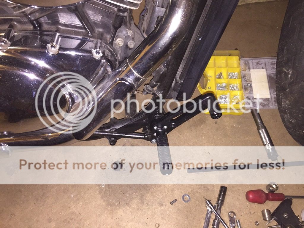

| Subject: Re: vl800 bobber build (on a tight budget) Thu Jan 05, 2017 7:30 pm | |
| ive got 4 days off work and a pass off the wife for workshop time so mocked up right forward control its in the correct position and working now. So i can make an aluminium bracket up tomorow out of some 10mm plate. going to clean the bike also as all the dust from grinding etc its filthy. then onto left side forward. | |
| Subject: Re: vl800 bobber build (on a tight budget) Thu Jan 05, 2017 8:09 pm | |
| Wow! they look cool | |
