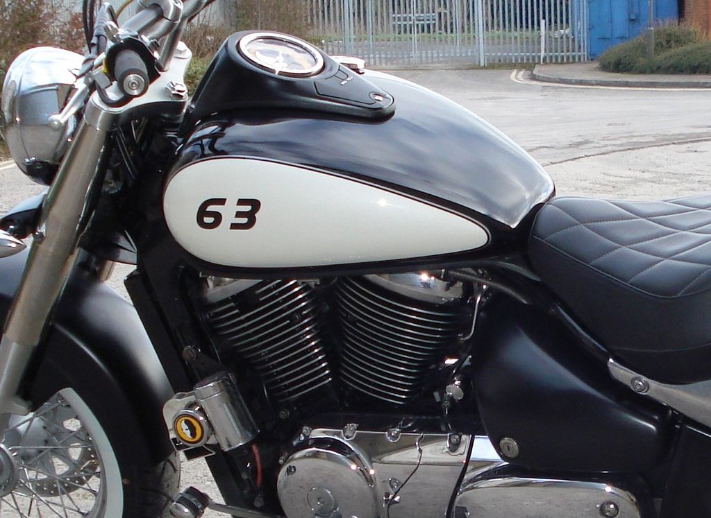

PostSubject: Re: pair blank help   Tue May 16, 2017 12:01 am
Look at picture 3 - see the two pipes marked "Pair Tube" - there the ones to block off.  Can't show you a photo of mine as I've completely removed the entire valve & pipework
[img][/img]

Good news - may be worth running it on a dyno at some stage. And getting rid of the pig ugly PAIR valve - get those jugs naked !
