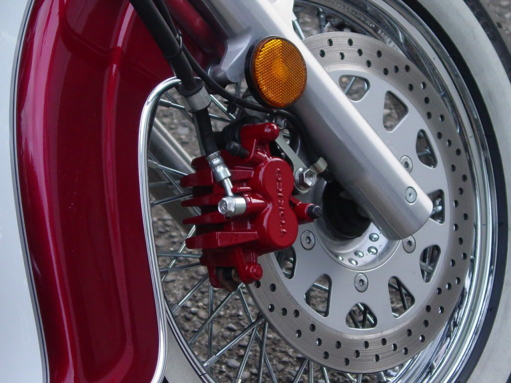

Spotted this today & I reckon it really makes the caliper look better, rather than the bog standard stock grey color

that looks realy good mr i, will have to source some paint to match my vl800, do you think it might need etching primer first though?

i will be getting mine done with the paint job but that red looks lush.
yes

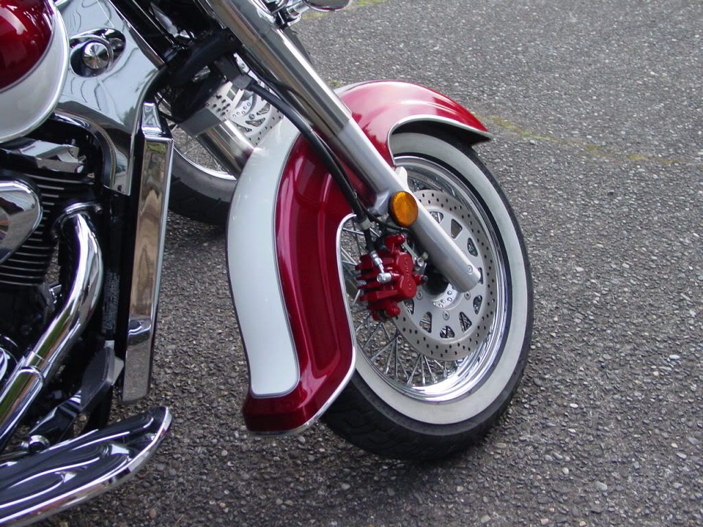

The white walls on that bike look great, in fact I really like the colour as well..

the bike could be in the U S white wall are standard on c50t
PostSubject: Re: * Spray Painted Brake Caliper on Suzuki C50T *   Thu Dec 22, 2011 5:37 pm
What I would like to know is where has he repositioned his Key ignition switch?
pledge
PostSubject: Re: * Spray Painted Brake Caliper on Suzuki C50T *   Thu Dec 22, 2011 5:49 pm
Hi Crash, I don't think he has repositioned the ignition switch, I think he has fitted some kind of chrome cap onto the key.
PostSubject: Re: * Spray Painted Brake Caliper on Suzuki C50T *   Thu Dec 22, 2011 5:57 pm
If thats what he has done then it looks real good like that & you could leave the key in and no one would know

Have to agree with Mr Intruder, Etch primer will give a key for the paint to bind to, go to any car paint shop supplier and they will be able to supply you with a rattle spray can, Doc Cox. E =MC2
PostSubject: Re: * Spray Painted Brake Caliper on Suzuki C50T *   Thu Jan 05, 2012 11:51 pm
You dont need to have primer What you can do and Ive done this meny times with car and bike calipers is get hammerit smooth dry gloss.
The reason you get this is its three times cheaper than caliper paint, you do not need primer or gloss, it can go staight on to the meatal, its heat resistant and looks great £7 for a small can will do 8 car calipers at three coats a caliper.
It so easy to do all you need a wire brish to take exess crap off, hot water and washing up liqued this will take of all grease and a paint brush.
It will take three to four coats 20min between coats and thin coats so that you do not get runs.
This has been tryed and tested ment times the down side you smell the paint for about three days and you have to do it again every 3-4 years.

agree with jim hammerit dont need primer but you could do the job what ever way you wanted as long as the paint you choose is suitable for the job
