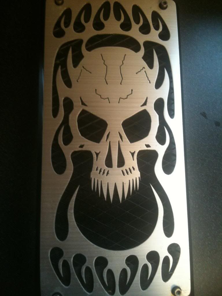

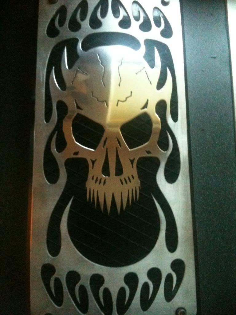

As you can see with some time and effort you can get the chrome two tone look.
This is simple to do as all you need is;
soap, water, wet and dry paper 800 & 400, Braso, clothes and about 2-3 hours work.

Such a good idea to have it two tone, different
PostSubject: Polished Aluminium Rad Cover   Mon Jan 02, 2012 7:26 pm
Very nice effect, I always forget about polishing ali
PostSubject: Re: Polished Aluminium Rad Cover VZ800   Mon Jan 02, 2012 8:54 pm
I didn't even know you could polish brushed ali to look like that you learn something new every day here
PostSubject: Re: Polished Aluminium Rad Cover VZ800   Mon Jan 02, 2012 9:19 pm
Yes you can rub it down but you will take the coating off, which is on it to stop it piting like alloys wheels but not to worry you could reseal using car clear laquer if you dont want the hassale of cleaning.
