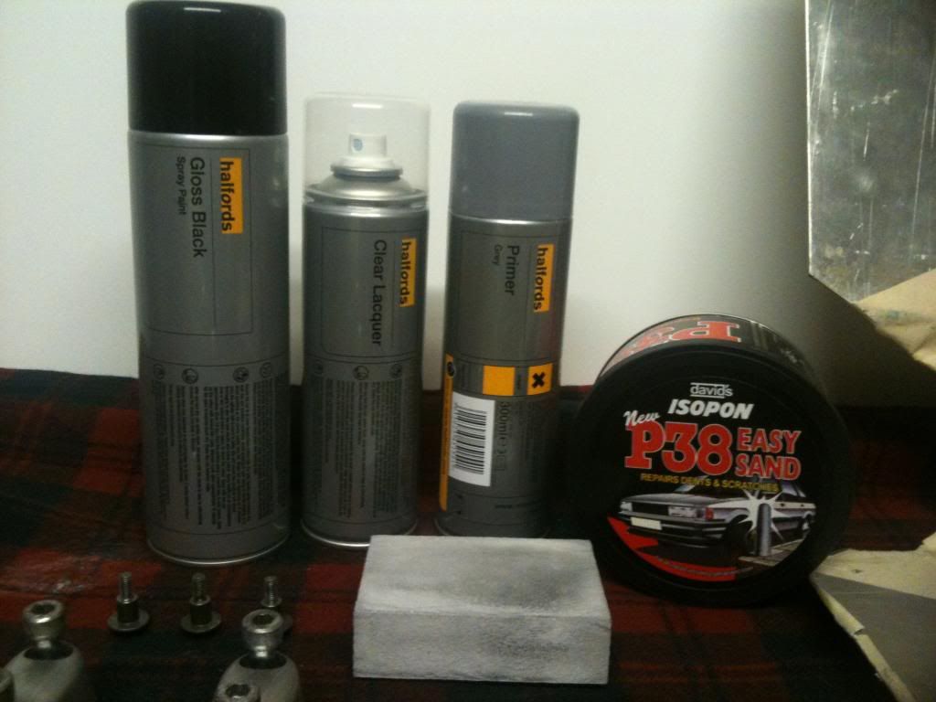

First this takes about 3-4 days with lots of patience, You will need a dremal tool (Hand held drill or cutter), sand paper, poly filler, primer, black gloss, clear lacquer, two 1" bolt and nut and pice of alloy to make a bracket.
The skull you can get from most tatto shops at a cost of about £10

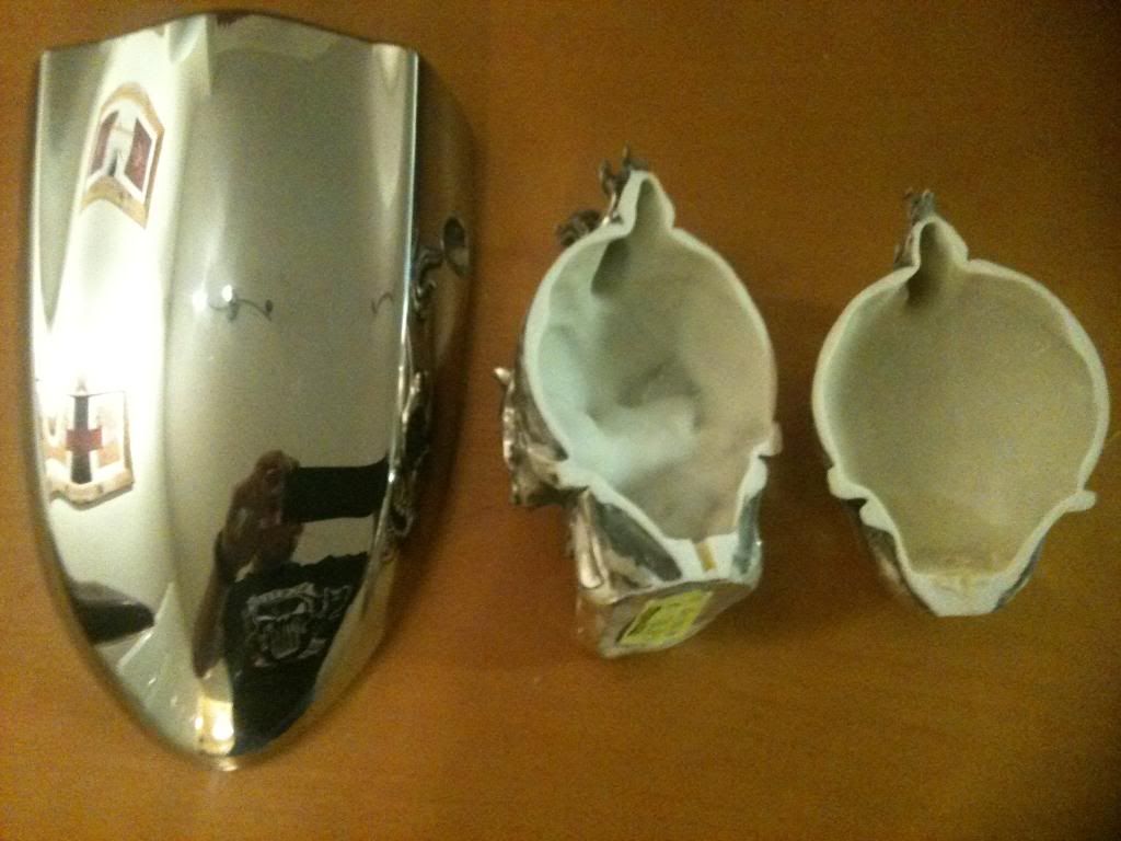

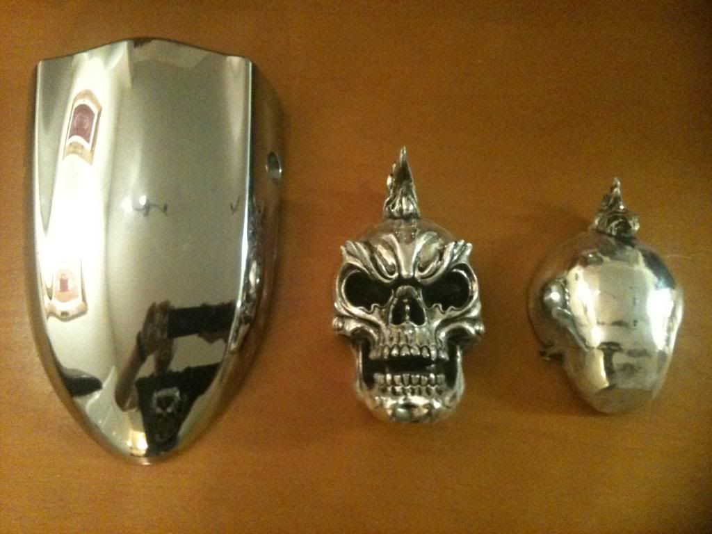

First you have to look at the skull and mark where you want to cut it, but be cairful as you can end up chasing your tail if not cut right.
Then you sould make your bracket so that when you mix the polly filler you can stick the bracket in to the skull, this will be done inorder to drill two holes in to the speedo cover inorder for the bolts to go through and fix in place from the in side.

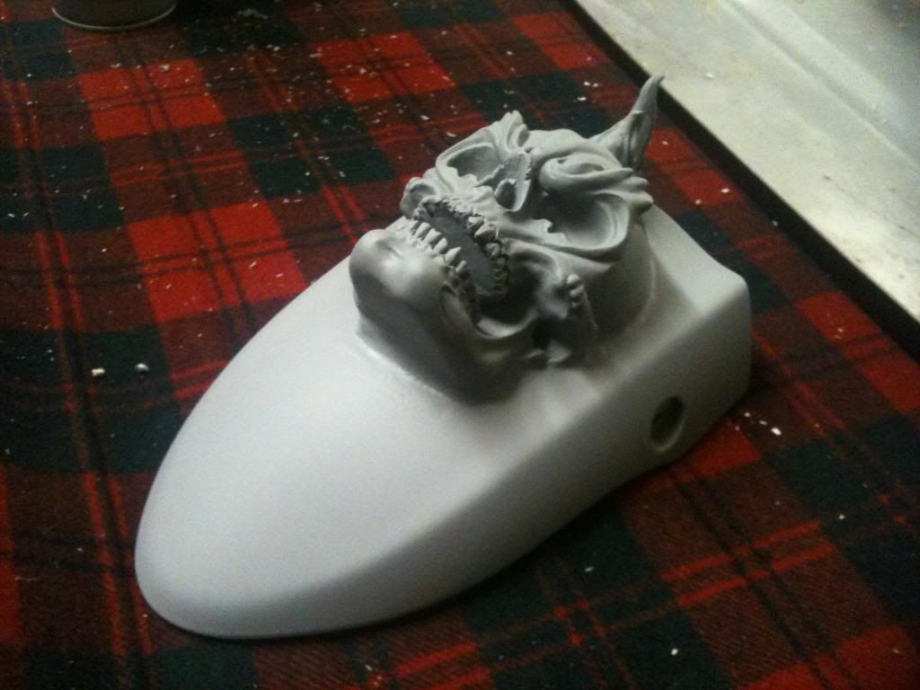

Sand the cover and skull until smooth and your happy, if you need to use more filler then do so, sand and fill, sand and fill.
Just when you think that your good to go use the primer to point out any flaws that you've missed.
When you have it all smooth give it two thin coats of primer, do not rush 15-20 min between coats.

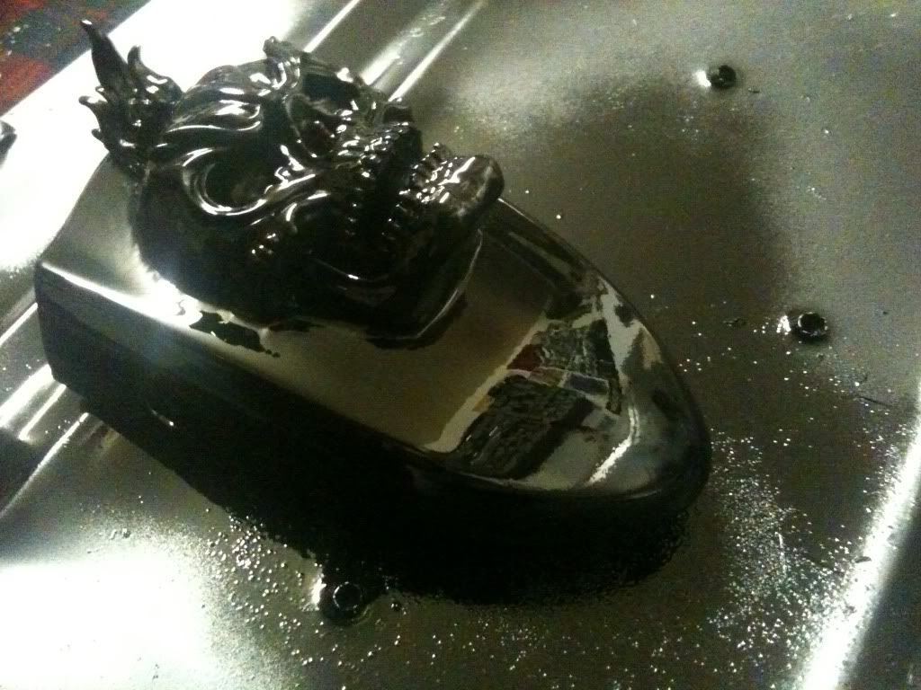

Once dry move on to the black 7 thin coats 15-20 min between coats and once you have finished the 7 layers allow 24 hours to harden.

This shows how it looks with just the black paint 9 coats latter over 24 hours.
Next step sand down with 1200 wet & dry then clear laqure, that will take place on Saterday.
