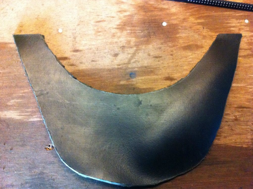

So after initially cutting out a section of the leather, I started marking out the leather with my pencil & cutting with my trusty dremmell
After finishing the cutting I ended up with the following
The only issue I have now is that the leather is bent and miss shaped but thats not an issue. What I did now was to spray the flap numerous times with wd40 until the leather could take no more. I did this because to re-shape the leather flat it was going to be put on the flat top of my boiler inside a bag with a couple of bricks on top for a couple of days. The WD40 soaked leather would then be rejuvenated and the heat and pressure would re flatten the previously bent leather.

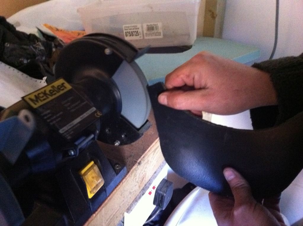

Next I cleaned up the edges with my bench grinder, little unusual maybe but it did a good job

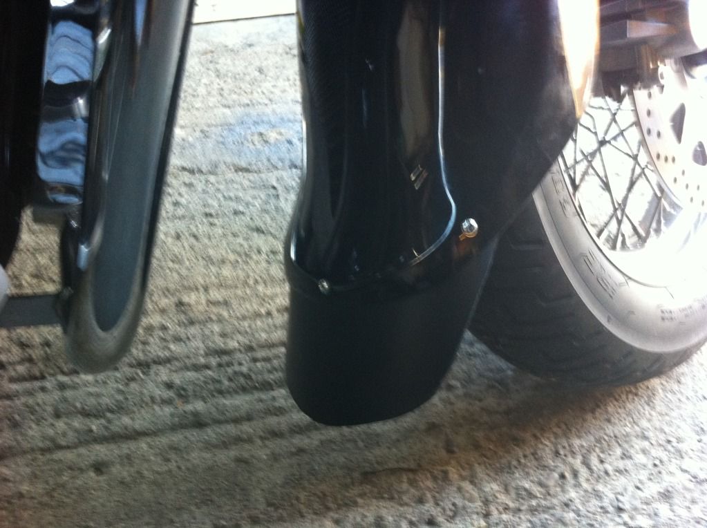

Next I drilled 3 4mm holes in the mud guard to take the flap. I then found the center of the flap and bolted that in position before doing the two sides.
At least now the road shite will not be all over the center of my chrome crash bars and chrome rad grill.
You could use various things to make a mud flap such as rubber but I used what I had to hand & I am happy with the result

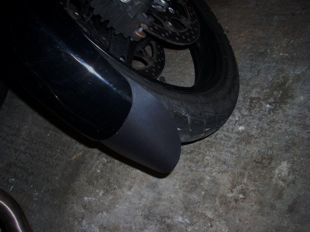

That's a proper job. Lucky that you had such quality material to hand - Suzuki couldn't match that. The shiny fixings give it a studded look which is very in keeping with the style of bike. Funnily enough when I saw yours Mr.I, I had just come out of the garage after fixing a fender extender on my V-Strom. I made it out of an Asda clipboard cut to shape and secured with impact adhesive. It must be the season for such things! Mine is not nearly so sustantial though it does the job intended at a fraction of the Suzuki accessory cost.

My mud flap has been on my bike for 2 months now and it has been dramatic how much difference it has made. This simple mod has made cleaning so much easier as it is now deflecting all the road crap back to the road and I have also noticed that I am not getting dirty at all around my lower legs or boots. So all in all its probably been one of the cheapest but effective mods I have done & I done a fair few
