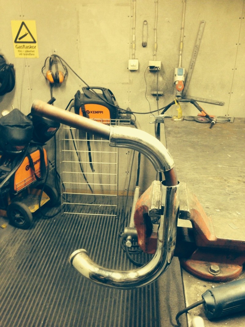

Decided to dismember the old pipes today.
Was a pretty straight forward thing. Tools needed: Angel grinder, Welding machine, permanent marker. Allso a pipecutter for 2" pipes made the job a bit easier to mark where to cut the pipes, but the outer pipe is a bit too soft to cut with the pipecutter.  And a vice made the work a bit easier.
Took me about 2 hours to remove the inner pipes and put everything back together again
Started off with cutting the left pipe at the end, just above the weld where the  pipe goes from 2" down to size. There the inner pipe is just slided together with a "pipe fitting".
Dissecting Rattlers Photo_20
First cut. No need to cut the inner pipe at that position.

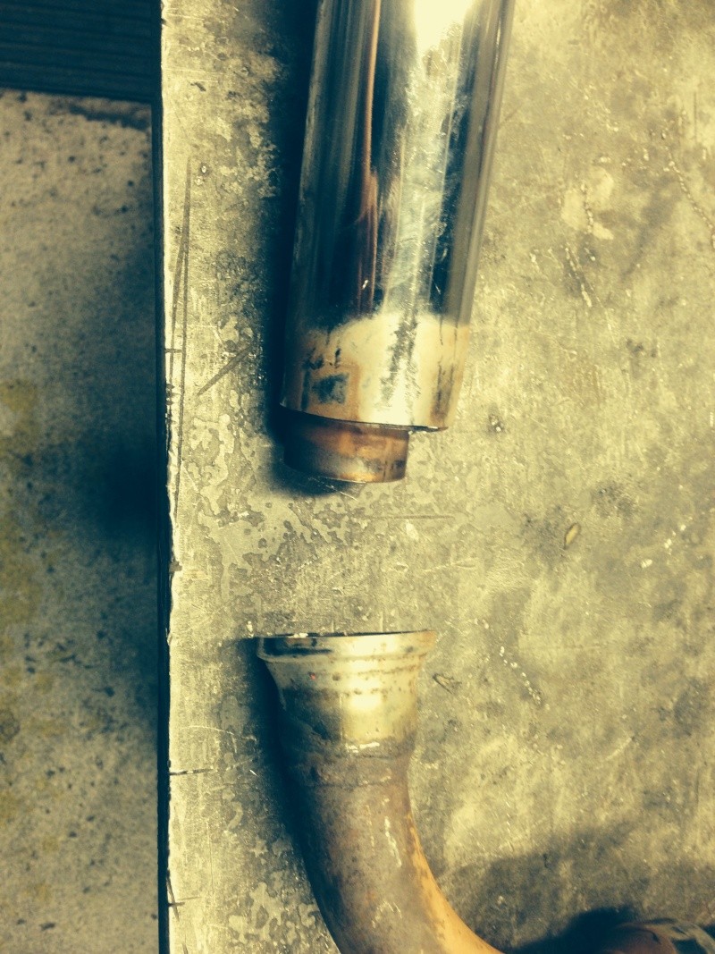

Dissecting Rattlers Photo_23
First section of outer pipe removed. Needed cut it in a few more pieces that i thought to get the inner pipe out.
Dissecting Rattlers Photo_24
Remeber to use the permanent marker before you cut the pipes to get them back in the right position. Wink

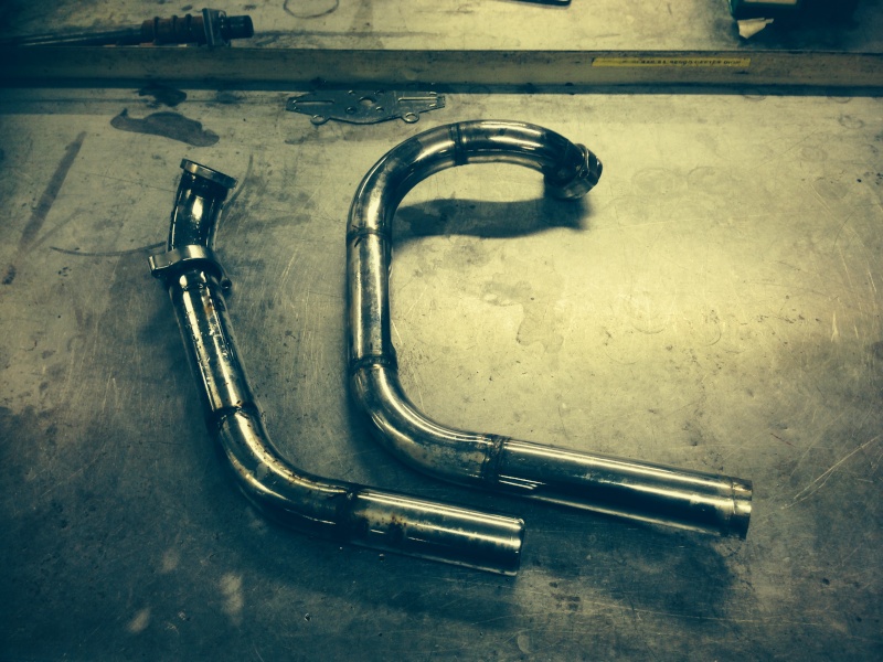

Dissecting Rattlers Photo_25
Both pipes put back together without inner pipes.
Was a bit more welding than i first thought and the chrome is never gonna be the same again. Lucky for me i had decided to paint them black and make some custom heat shields.
Next step is to fit the pipe thats gonna be the connection to the end section to the exhaust.
Make heat shields, and weld brackets for them to the exhausts.
What do you think.... should i continue in this thread or should i make a new one with the the updates ?

Looking good Twenty2, real good. You definately are not scared to dig deep & get to the root of the problem  Dissecting Rattlers 184121345
I think the way the thread has gone it is a very informative bit of reading & if your OK with it, I will simply ask Mr Intruder to rename it "Dissecting VZ exhaust rattles & modification thread" or something similar?
It's your call but there is very relevant info here on the topic that would easily flow into what your doing Dissecting Rattlers 184121345

Nice job and write up twenty2  Dissecting Rattlers 2170595768 Although your post is very relevant to this thread? I believe it deserve's it own thread in the exhaust section as a 'how to' for a common problem on the VZ800   Dissecting Rattlers 3498837457

Really helpful and in depth cover of a vz issue.
Thanks for the upload and agree with Simbo , This deserves its own thread.

Thanks guys.
Been doing a bit of thinking on the ratteling issue.
What i noticed when i opened up the pipes is that the inner pipe is only fixed at the top, inside the pipe flange to the cylinder. on the outlet side of the pipes, where it goes down to 1,5" (?) it is just 2 pipes that are fitted into each other. Might be a easy way to fix the rattling if a  0,5 " hole is drilled near the weld where the pipe goes down in size. And just make a weld through that hole.
my idea is that the innerpipes will get welded together in the connecting part. And that the ratteling will stopp.
Just an idea but it seems quite logic, that the pip fitting slides a little bit and then the pipe aint as fixated as it should be.
