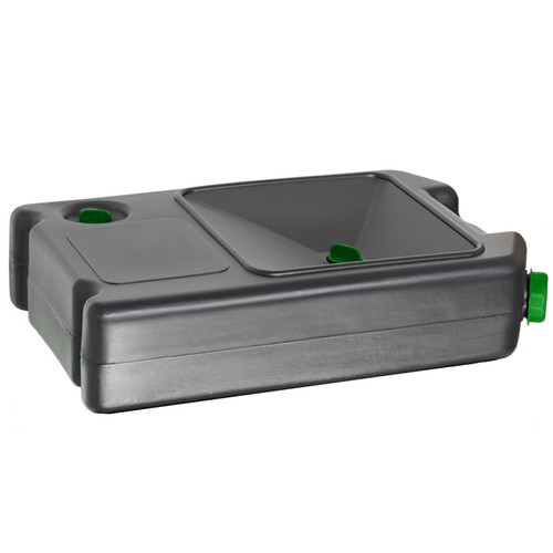

One thing I picked up recently that was on offer at a motor-factors was a low profile oil drainer pan.
Oil Confusion $(KGrHqVHJFIFIuP(1dDcBSNq8Plh8g~~60_12
This replaces the 'home-made' 5-litre poly can that I've been using for the past 30-40 years.
I liked the 'low profile' which will be useful for some cars I have worked on .... also a nice funnel to catch the waste oil, and the container can be sealed & used to take the waste down to the local amenities site (You could decant it back into an old oil container is you wish to 're-use it .... like those Yorkshiremen that paint their garden fences with it !!!!! )
This was an impulsive 'treat', but I am pleased with it & it is great for servicing the 'VX'.
