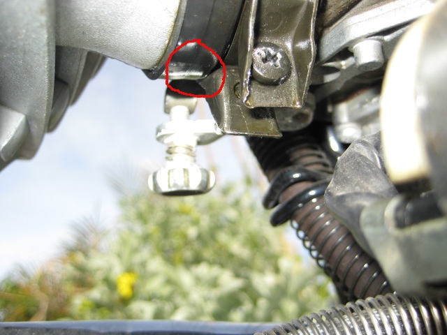

Hi guys,
I just bought a 1997 Intruder 800, with 5k miles and for the first 50 miles, it ran fine. However, when I checked for possible leakage, I start to notice a possible leak at the joint of rear cylinder and its carb. I was not sure so I did an odor test, and it did smell like gasoline, and it did feel like oil with light brownish color. This led me to check on the cylinder head gaskets, both front and back have what looks like high-temp RTV instead of the normal thin sheet of black OEM gaskets. So I assume the RTV was put in place due to some sort of leak. Do you think this has led to the leakage at the rear cylinder-carb joint? I came to this assumption due to the fact that I read on some Q&A where it is said that cylinder head gasket failure can cause oil leakage at the cylinder-carb joint. Also, I have attached a picture where I red-circled the area where the leakage was found and the RTV on cylinder heads. If this turnout to be a major problem, should I need to look into the possibility of replacing both cylinders with OEM gaskets?
Thank you guys

I looked at the pic you have posted and I am confused (nothing new  possible leakage at rear cylinder-carb joint 215375), you say your bike is a 97 USA Intruder but from what I can see of the carb it looks wrong to me, the intake rubber (item 42 in the image below) normally has a flange on it that bolts to the head with the carb sliding into it and being sealed by the clamp (item 45 in the image below). Or I could be totally wrong and talking out of me a**e again (again, nothing new possible leakage at rear cylinder-carb joint 215375), any chance of a some more pics from different angles?

simbo, here are snapshots of the oozing RTV, and I did some research to understand that this is very common even on newer years, which leads me to think that this is how it came out originally
possible leakage at rear cylinder-carb joint Img_1213
possible leakage at rear cylinder-carb joint Img_1214
and these show where I spotted oil, first pic is where I just found it after the ride back from the shop, second pic is when I first got the bike, after 50 miles ride home (on three consecutive fins).
possible leakage at rear cylinder-carb joint Img_1215
possible leakage at rear cylinder-carb joint Img_1216
this shows oil residue at the very top of the rear cylinder, if you look closely, you will see a faint yellowish line in the second pic
possible leakage at rear cylinder-carb joint Img_1219
possible leakage at rear cylinder-carb joint Img_1220
and this is the rear carb that I mentioned previously about the leak
possible leakage at rear cylinder-carb joint Img_1221
