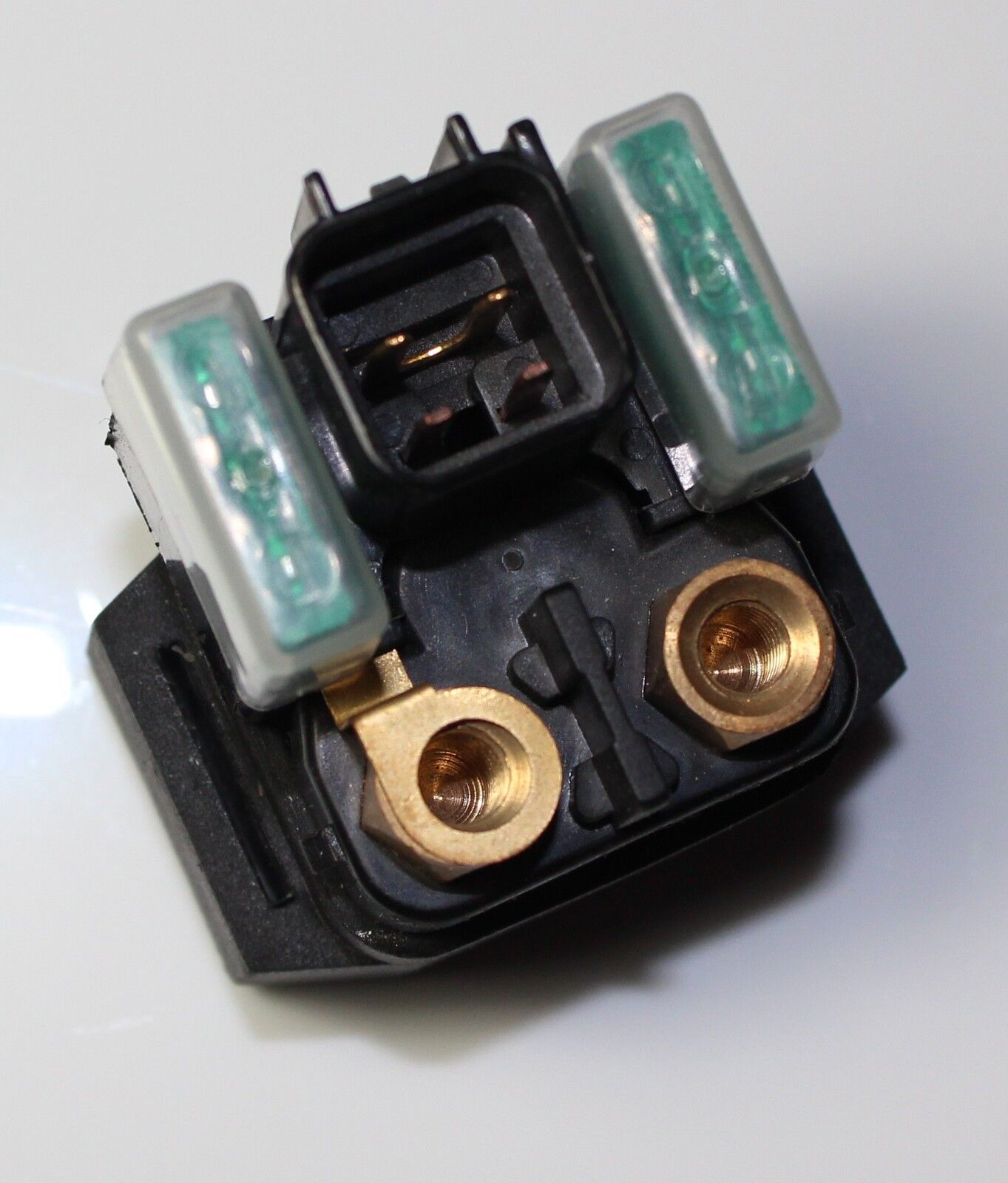

Like this one?

Yes, that's the solenoid.
It's the connector (that's not shown) that I need to replace.
The bike has broken down on me too many times now. I have already replaced the solenoid but the connector is proving difficult to locate.
