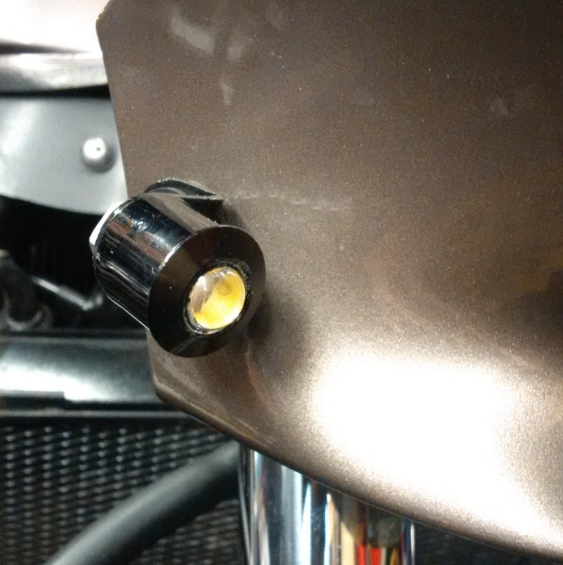

Well I finally got round to fitting these:
Daylight Running Lights Drl10
With a bit of head scratching I came up with a plan as to how I was going to fit them, another couple of ebay purchases (some S/Steel brackets which I drilled out, bent to shape and then sprayed black and some plastic spacers).
Daylight Running Lights Bracke10
Daylight Running Lights Spacer10
It ended up looking like this.
Daylight Running Lights Img_2010
Daylight Running Lights Img_2011
I did have the bracket the other way round for a start with so that the fairing fixing was hidden but on full lock the back of the DRL fouled on the oil coiler.

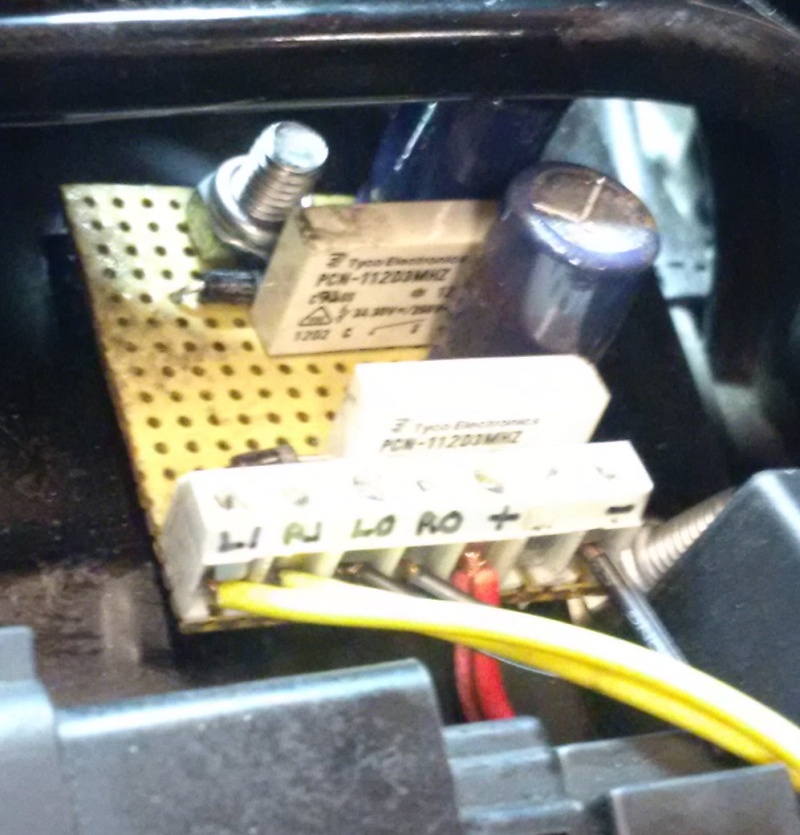

I then set about wiring them in, I bought a small black box that dims the DRL's when you turn the lights on but I also wanted the associated DRL to go off when you used the indicators. When the indicator flashes on it turns on Relay 1 and also charges the Capacitor, when the indicator goes off the Diode stops the backfeed and the capacitor discharges (takes about 3seconds) but the indicator flashes on again (before the capacitor discharges) re-charging the capacitor thus keeping the relay on until the indicators go off for good, then the capacitor discharges totally and the relay opens.
When Relay 1 closes it turns on Relay 2 which breaks the circuit to the DRL's. The reason I have done it this way is due to the impedance of Relay 2's coil, I would need a massive capacitor to keep it powered on for 3 seconds, whereas the small one on the PCB has a higher impedance so the capacitor can be smaller.
Daylight Running Lights Circui10
Daylight Running Lights Img_2012
Daylight Running Lights Img_2013

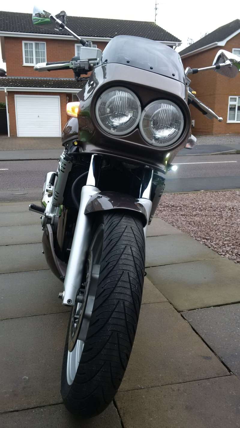

DRL's on by themselves:
Daylight Running Lights Img_2018

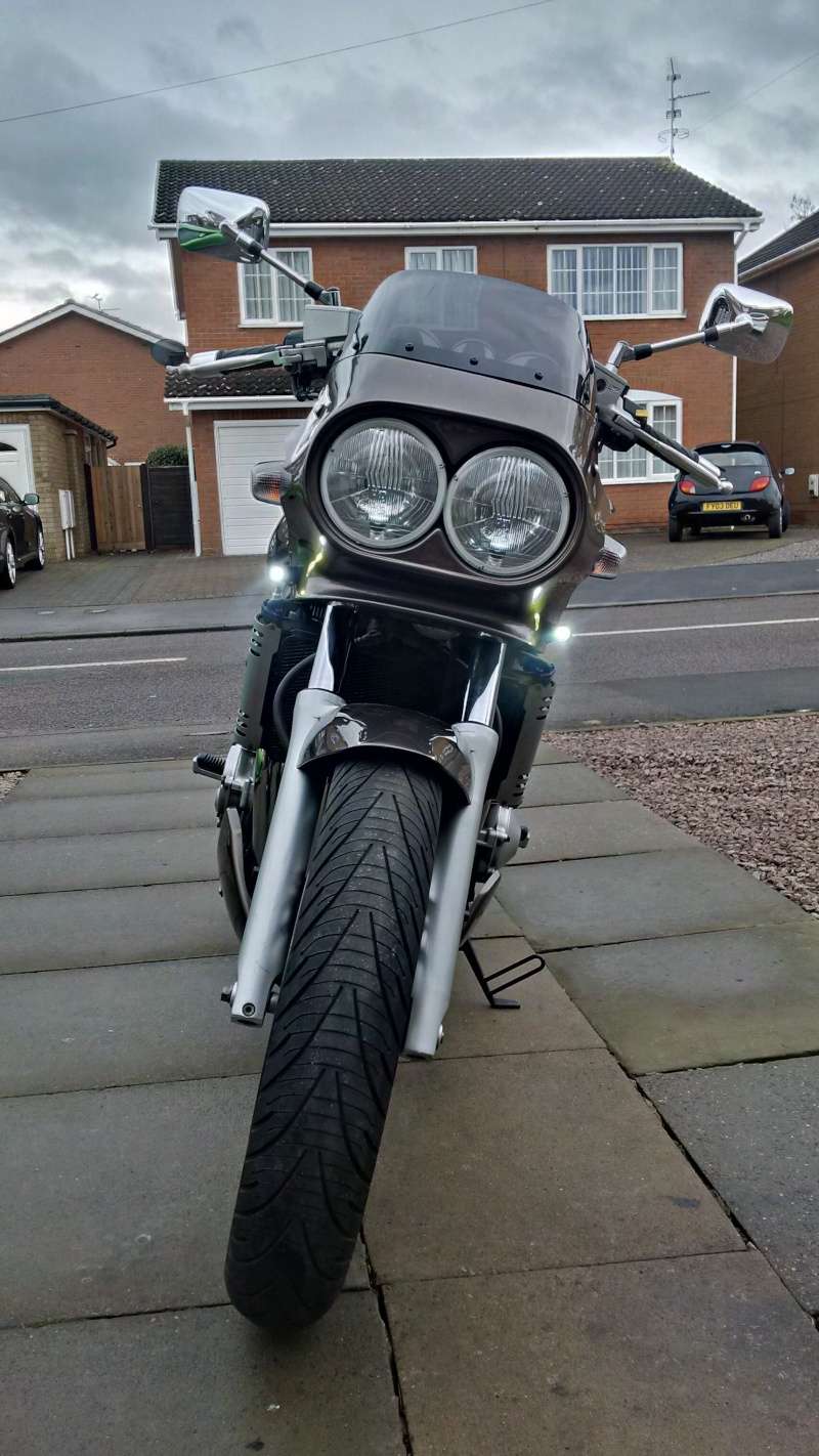

DRL's dimmed when the main lights are on:
Daylight Running Lights Img_2019
Left DRL goes off with the left Indicator:
Daylight Running Lights Img_2020
Right DRL goes off with the right Indicator:
Daylight Running Lights Img_2021
