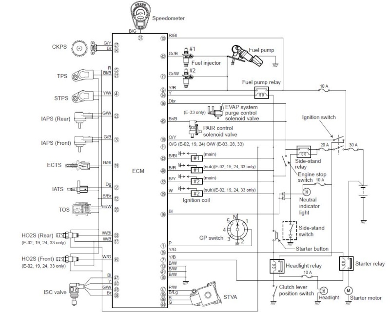

This is what I think is your bikes wiring diagram, can you hear any relays energise when you turn the ignition on. If your engine turns over then the side stand relay is working as is the engine stop switch. The only relay that should energise is the pump relay, it has a 10A fuse, it could be that or even a bad earth to the pump.
Before i lose my mind, why wont it start ? Vz800f10

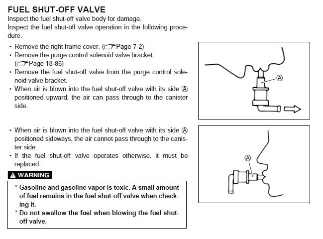

There also looks to be a one way valve which could be worth a look.
Before i lose my mind, why wont it start ? Shutof10
