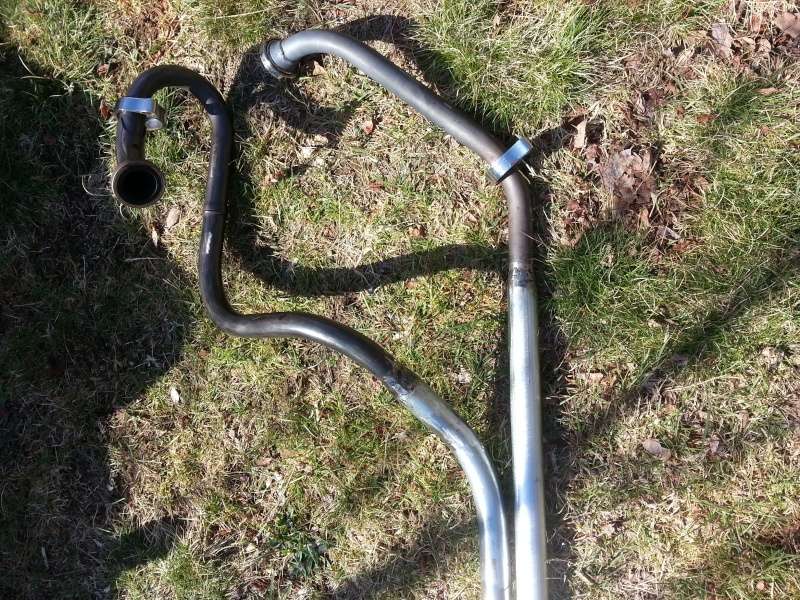

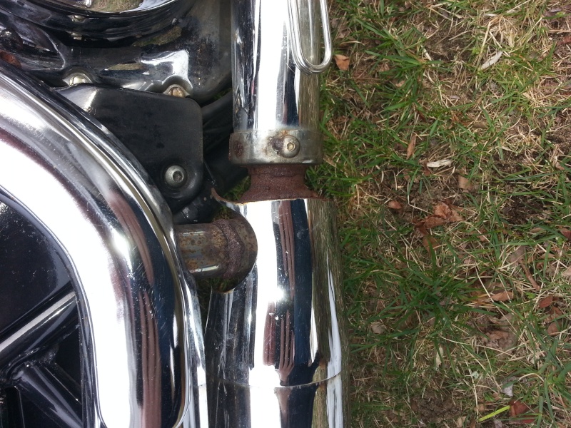

Torpedoes into slashcuts 20160413
Torpedoes into slashcuts 20160412
This is what my exhaust looks like now, so I don't think any alteration I make will make it worse, short of destroying it mechanically.
Sorry they're sideways

[size=51]I striped down the stock exhaust, lost all the heat shields and mufflers, and only reused the the inner headers. [/size]
[size=51]Then with a $10 piece of 1 1\4 metal conduit, and a $5 90° bend of the same stuff welded up to the headers, tested for leaks, cut the slash, installed a lollipop baffle, painted, and wrapped them. Maybe $40 and they rock.[/size]
[size=40]I hope the photos load the right way, but here goesTorpedoes into slashcuts 20160427[/size]
[size=40]Torpedoes into slashcuts 20160425[/size]
