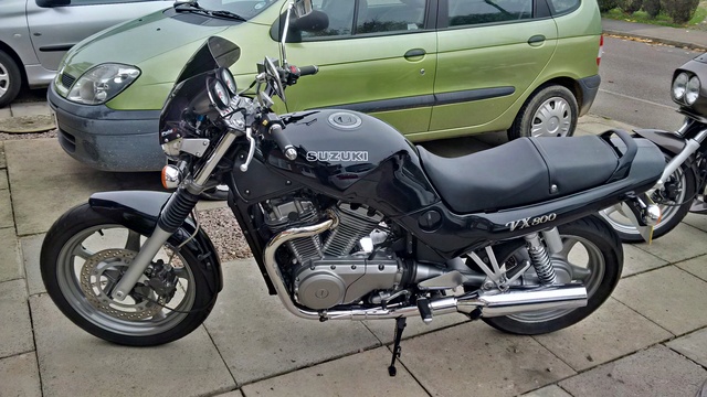

Have you got any photos of the 2??
What are the engine codes??
This was my old girl
Vx800 stator plate sizes and swapping one for another Img_2010
