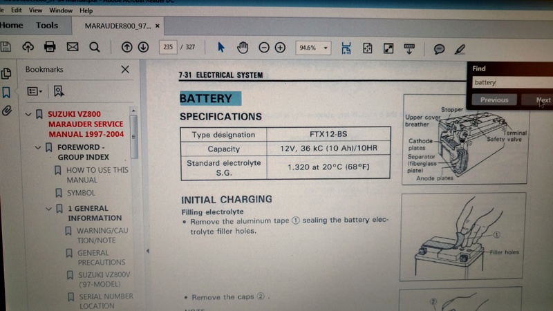

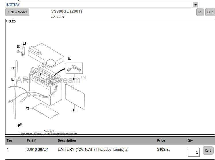

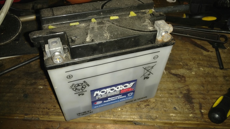

Well, I finally got off my arse and dropped the battery so I could get some solid answers on a replacement, (and also just realized there's an entire "battery" section of the site where I probably should have posted! Der!). The connectors you can see in the first pic are just the battery tender cables that I installed when I got the bike; the actual cables to the bike have NO room to drop them, and in the second pic, you can see that they "conveniently" placed the negative cable that you need to disconnect first, right behind the voltage regulator w/heat sink fins, so that it has to be unbolted at least, (not disconnected), to get at the negative connector at all. The 3rd pic shows the positive connection, that can easily be gotten to before lowering the "trap door" bottom plate that holds the battery in by removing the two screws that secure it in the up position under the battery, (can be seen just behind the battery in the first pic). You can also see that the positive side of the battery box has a small recess pressed into the side of the metal, (best seen in the shot of the positive cable connection), and the battery itself has a small lug in the plastic cap on that side, which I presume was a design feature to 1): make sure the battery only goes in the one way, and 2): keeps the battery from flailing back and forth in the box, which keeps it centered and stationary, so I'll have to figure a way to remedy that, if the replacement I decide on does not have this feature built in. Also, as you can see, the dual front and side connections on this battery itself was a boon to having a spot to connect the tender on the front, and the bike cables on the sides as necessary. As this battery is obviously a wet-cell, (in the bench pic you can see several of the cells are below level on electrolyte, and could probably be filled to extend the life of the unit?), I'm looking to go with an AGM maintenance free unit, which should last close to 5 years or better without issue from all I've read, but I apparently need to find something with the connections I need, and make sure it will stay put as with the built in locator lug on this unit. Will post a solution when I come up with one and do the install. Just removed this one completely, as there's nothing on the bike that needs power currently...

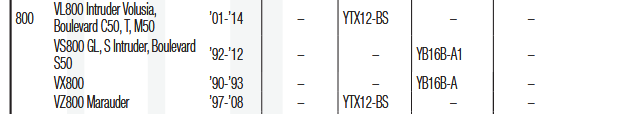

Yeah Peter; it's a pretty tight fit in there, and unfortunately, it's proving fairly difficult to find a good branded AGM battery that's specific to this model for some reason?  I've found a few Lithium-Ion versions that say they'll fit, but the connections on most anything I've found aren't the same as this one, which will make it very difficult to attach the tender cables as I'd had them, but probably not impossible. While the lithium batteries boast much lighter weights, and seem to have plenty of power, they don't appear to hold up very well in colder temperatures, so I've shied away from them for the most part, and they are nearly twice the price of most AGM batteries to boot! Ahhh; the search goes on...

So hopefully I've found a proper replacement; this BikeMaster MG16-BS. It doesn't show as fitting the bike on most battery replacement listings where I've found it, BUT, the size is identical, and so are the connections, so I can't see it not working. I hope not, as I just ordered one from eBay for $81, and it should be here from California early next week. It's "TruGel" construction is supposed to be capable of install in any orientation, and with 200 CCA, it should have plenty of power, and boasts that it should have a life double of any conventional battery, so we'll see. I'll post more once I see how things go...

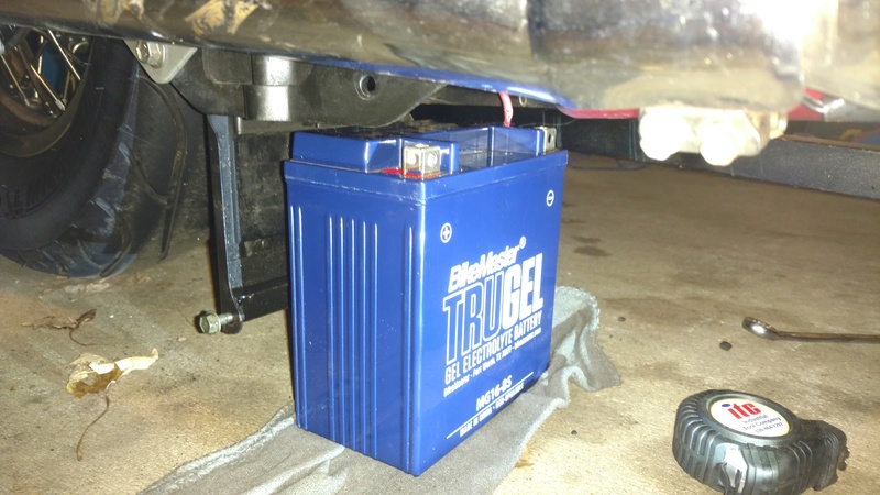

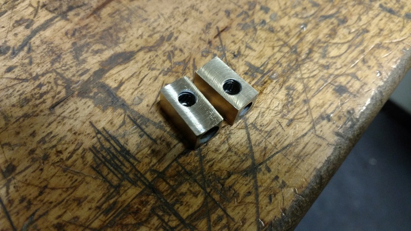

So after a bit of fiddling, I got the BikeMaster Tru-Gel fit in, and it whips the motor over toot-sweet; sounds real healthy in cranking speed! I did have to make some slight modifications to the connectors however, but the battery itself fit in quite snugly. These terminal blocks that were in the original battery were about .69mm too big each way to fit in the metal housings of the new battery terminals, but a few minutes on the hand mill, (Bridgeport), at work, took care of that straight away, (before and after milling pics).
Battery Replacement Conundrum Origin10
Battery Replacement Conundrum Milled10
Also, it seemed the positive cable end to the bike, was just a tad too long from the screw hole to the end of the of the connector to fit properly to the battery, (see red arrow of old terminal pic for clarification), but a couple minutes with a good file took care of knocking the end down enough to allow proper fitment.
Battery Replacement Conundrum Batter15
Battery Replacement Conundrum Bikema10
So all in all, pretty happy with the battery they said "didn't fit" my 2001 VS800GL, and we'll see how it holds up. Got the motor warmed and changed the oil after the battery fit up, so now it just needs a good washing, (planning on doing so this afternoon), plus I'm looking to upgrade the headlight to either halogen or COB LED, and I'll be ready for the spring. As of now, they're talking about 3 inches of snow tomorrow! Battery Replacement Conundrum 437349
