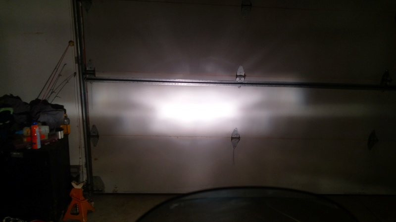

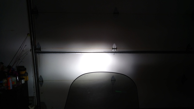

Well, I have fitted the LED light bulb upgrade, and just from the inside the garage observation, am slightly underwhelmed with the results, but haven't had a chance to night ride yet, and see the critical true test of vision and visibility. I'd have to say that the low beam shows marked improvement, but the high beam doesn't seem as brilliant as I'd hoped; at least initially. Unfortunately, I didn't take any street "before" shots of night vision in a specific area to compare to, but the light definitely looks a lot "whiter", and I'm not sure how much truth my Motorola phone camera is capturing as far as captured reality, but I'll post the pics for everyone's perspective...
This was the low beam before:
Halogen/LED Headlamp Upgrade? Before10
This is after:
Halogen/LED Headlamp Upgrade? After-10
This was the hi beam before:
Halogen/LED Headlamp Upgrade? Before11
This is the hi beam after:
Halogen/LED Headlamp Upgrade? After-11
You really have to look at each side by side to get a fair comparison, which is what leads me to believe that the photos aren't telling the whole truth. The light certainly seems much brighter when looked at, but pictures of the light head on don't tell you much either; other than my eyes hurt! The installation wasn't very difficult, but did require some slight modifications of the rubber boot that covered the original bulb, (to fit the heat sink portion of the LED unit), and also the retention spring that held the bulb in pressed slightly on the side of the cooling fan housing, but a minor twist with a pair of needle nose pliers took care of that easily enough. The "Ching-glish" instructions were quite comical, and only slightly helpful, but any minor mechanical ability would make the swap easy enough. The light came with (3) adapter rings, (one for H4 and a couple other types), plus a spring, in case the factory unit wouldn't work. You can see in the pics a small white rubber seal ring, that left the light a little loose against the adapter ring, but a tiny rubber band installed behind the seal ring took care of that.

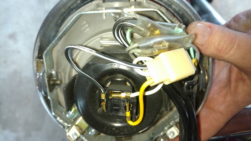

This is how the unit came out of the bike originally:
Halogen/LED Headlamp Upgrade? Img_2021
LED unit in the box:
Halogen/LED Headlamp Upgrade? Img_2020
On the left where the spring comes close to the housing is where I had to bend it slightly to allow fitment, and the white seal ring is visible under the heat fan unit:
Halogen/LED Headlamp Upgrade? Img_2016
Rubber boot from factory:
Halogen/LED Headlamp Upgrade? Img_2017
Rubber boot modified to fit cooling fan:
Halogen/LED Headlamp Upgrade? Img_2018
This is the final assembly with everything back in; I believe the boot still gives the cooling enough air to breathe, although all reports say these things run even cooler than regular bulbs:
Halogen/LED Headlamp Upgrade? Img_2019
Can't wait for night ride weather now so I can see the true "proof in the pudding" as they say... Think my next upgrade is going to be some extended custom mirrors. Those factory units have always been a little short of being able see much around my shoulders, and the new handlebars I put on last year only brought them lower and tighter to center, so something better and sportier is surely forthcoming...

Yes Sim; the colour difference from the traditional bulb was distinctly noticable. It also lit up the inside of the garage a lot brighter all around, so I'm expecting the road performance and visibility will be greatly improved.

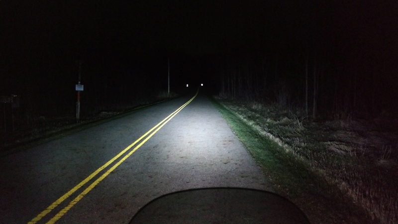

So, here are some real world results of the headlight upgrade, now that I've inverted the hi-beam panel to face downward, which in effect, shines the beam higher and farther forward, and a little directional adjustments with the old screwdriver. I'm not as impressed with the hi-beam, (can see the trees pretty well!), but the difference in the low-beam may have well been worth the swap on its own...
Low-beam:
Halogen/LED Headlamp Upgrade? Lowbea10
Hi-beam:
Halogen/LED Headlamp Upgrade? Hibeam10

PostSubject: Re: Halogen/LED Headlamp Upgrade?   Halogen/LED Headlamp Upgrade? Icon_minitimeWed Apr 25, 2018 8:45 pm
looks pretty good mate just be carful of parking up at carparks out of town and sitting there flashing hi/lo beam someone might think your dogging  Halogen/LED Headlamp Upgrade? 852880

Yeah; I thought about that! I took both sets of photos at two different park entrances just around town here, where I'd figured no one would be about after dark, but still wondered who might be lurking in the darkness of the woods around me doing lord knows what!
