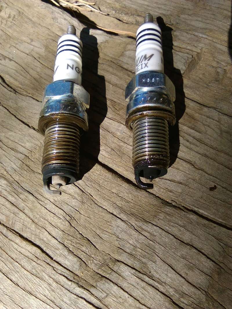

The front plug burns a bit black and i am hoping that by turning the mix screw to one and a half, as opposed to two and a quarter, they might burn evenly.
I'd like to post a picture of the pair of plugs for comment, but in the process of trying to upload the image, i lost everything and had to start my missive again.

Here's me trying to upload a picture of my two plugs.
VZ800 Compression question Img_2010
And heaven knows, i seem to have succeeded.
Any comments on mixtures or balancing. Please.
The black plug came out of the front cylinder, which was what made me worry about compression in the first place.

PostSubject: Re: VZ800 Compression question   VZ800 Compression question Icon_minitimeSat Feb 17, 2018 9:05 pm
Balance the carbs before changing any mixtures, for reference I think the rear main jet is slightly bigger than the front on these bikes, just in case someone has been playing Wink
