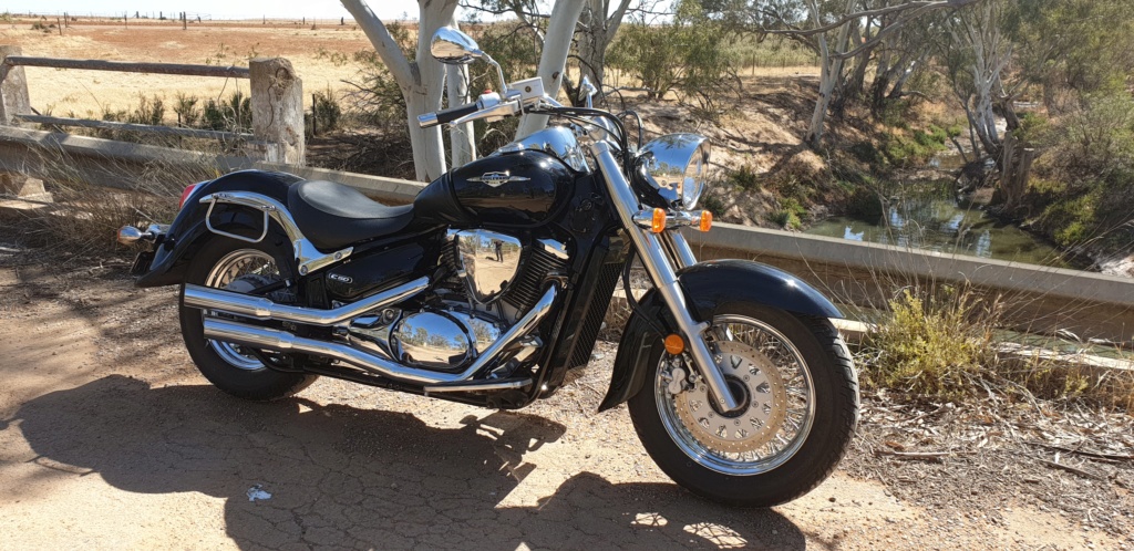

After lots of questions with lots of conflicting answers i thought stuff it i'm going to get a FI Tuner, it can't hurt anything but my wallet LOL!...
So today i fitted the Healtech FI Tuner and a K & N Air filter with my already fitted Vance & Hines Exhaust...
Took longer to read the instructions than it did to fit, it's that easy! Connected the Laptop and again followed the instructions and bang it was all fitted and map loaded...
Next up was a ride to test it out and i'm glad to say the bike ran smooth as! No problems at all!...
Glad i did it as i know now i'll have no lean running problems from fitting Exhaust & Air Filter....
Cheers ChuckTHealtech FI Tuner Installed.... 20191112
