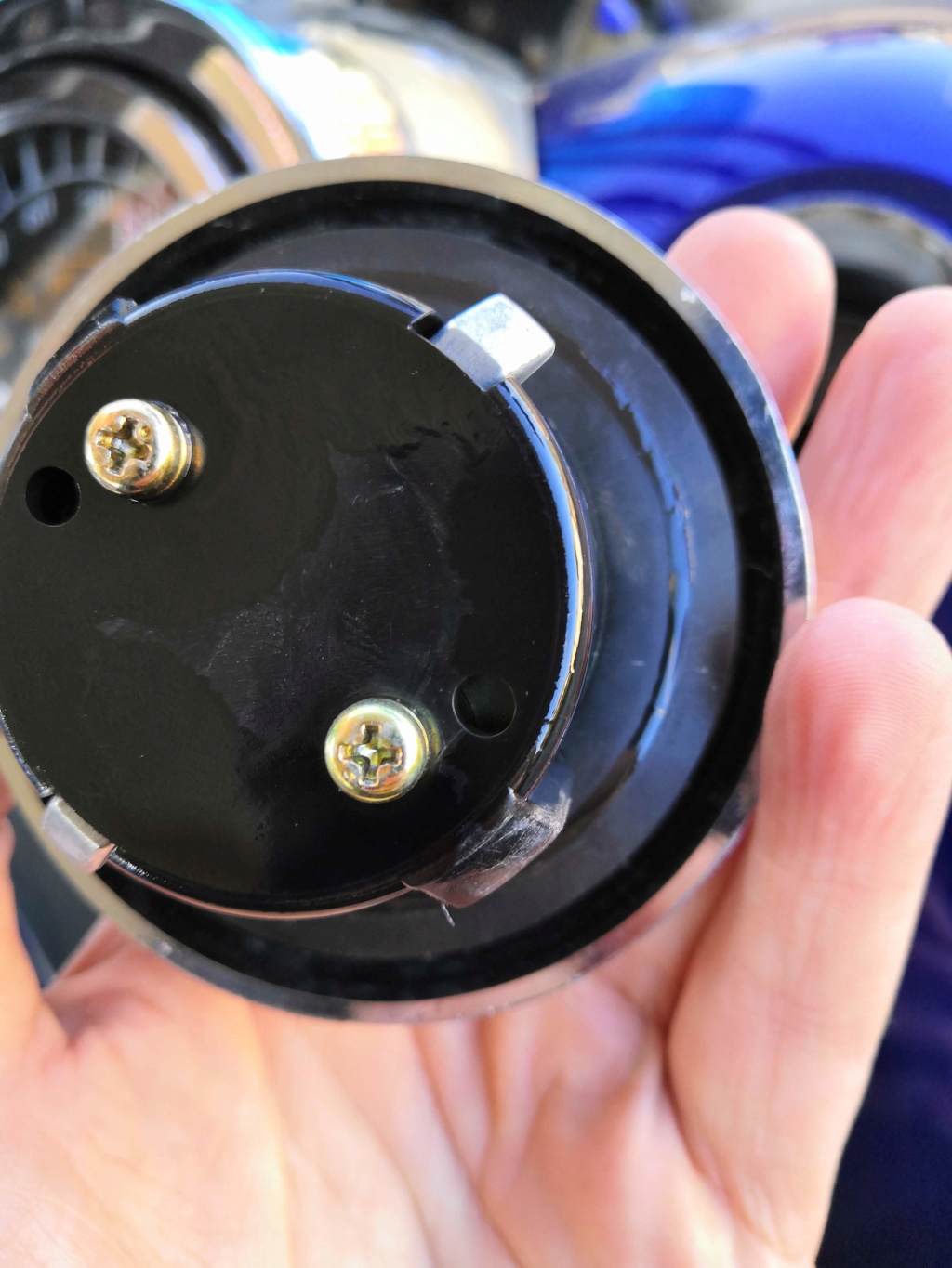

If you're getting strong whiffs of fuel while riding, it may well be your petrol cap rubber gasket.
Mine when inspected had cracked and hardened. I looked online to find Suzuki DO NOT sell the gasket by itself, instead they expect you to fork out for an entirely new petrol cap.
So instead I took the old gasket off, just two screws then you can pull it off, and measure it.
The stock one is a 36mm ID, 62mm OD. Closest I could find is this:
https://www.ebay.co.uk/itm/3MM-THICK-VITON-A-FKM-HIGH-TEMP-RUBBER-WASHER-SEALS-DIESEL-PETROL-OIL-RESISTANT/372632387997?ssPageName=STRK%3AMEBIDX%3AIT&var=641648590394&_trksid=p2057872.m2749.l2649
Which is the same ID but slightly larger OD. I put it on as it was without cutting it to size and there you go. It sits on the tank noticeable more 'cushiony' now for lack of a better word, and after several long rides I can confirm it is sealing properly with no issues at all. Here is a photo after a long ride and removing the cap:
Bike smelling of petrol - petrol cap gasket Img_2010
As you can see the fuel is not escaping the cap and no more fuel smells! Hope this helps as it took a while to find a premade gasket, you could of course just buy a sheet of fuel resistant rubber and carve one out yourself also.

Nice fix.   Naughty of Suzuki that.  I'd say that is a perishable item, that should be in stock.

In fairness when I was researching the problem, Suzuki aren't alone. Most manufacturers just dont sell the fuel cap gasket as a stand alone part, hence the huge amount of aftermarket gaskets sold on Ebay, none of which are 'OEM' official. Just glad its fixed, i like the smell of petrol but not all the time.
