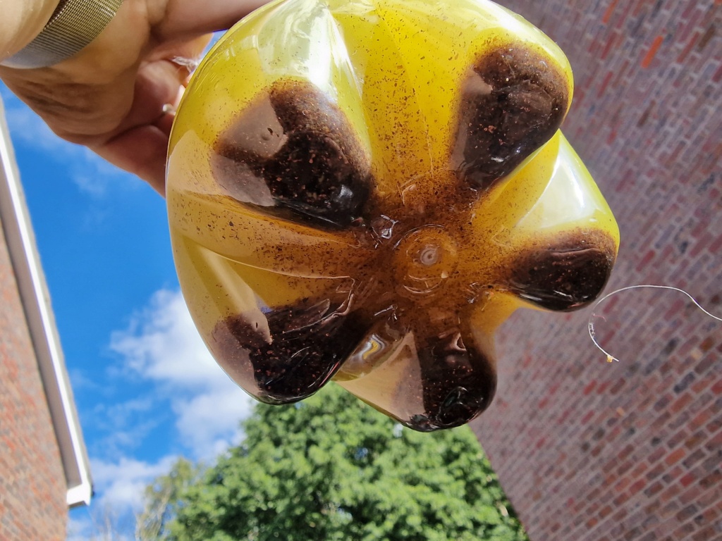

Lessons- Don't leave K-seal in your system. I used the recommended amount and 4 bottles of the below pictured sludge came out. K-seal worked great, but I think it killed my radiator cap.
Inspecting the waste coolant/flushing containers a few days later, the amount of crap that settled was a surprise.
Sach Roadster 800 Coolant Change & K-Seal advice 20220812
Sach Roadster 800 Coolant Change & K-Seal advice 20220813
