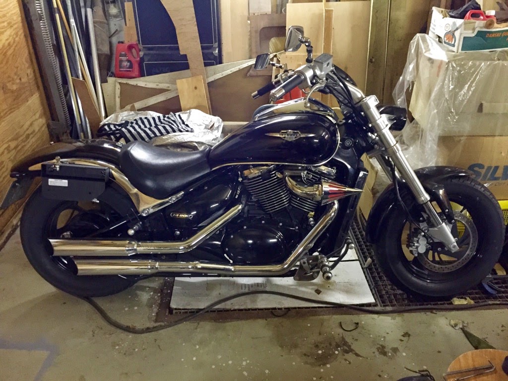

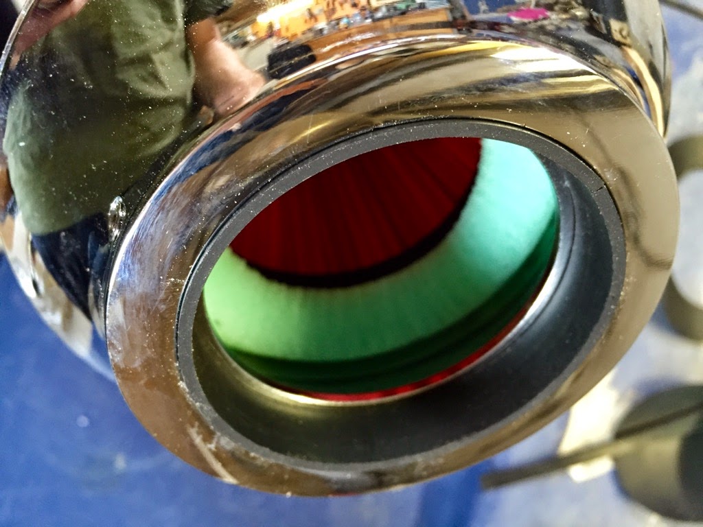

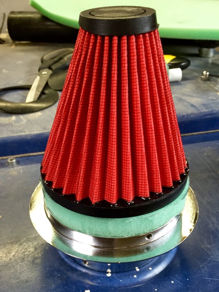

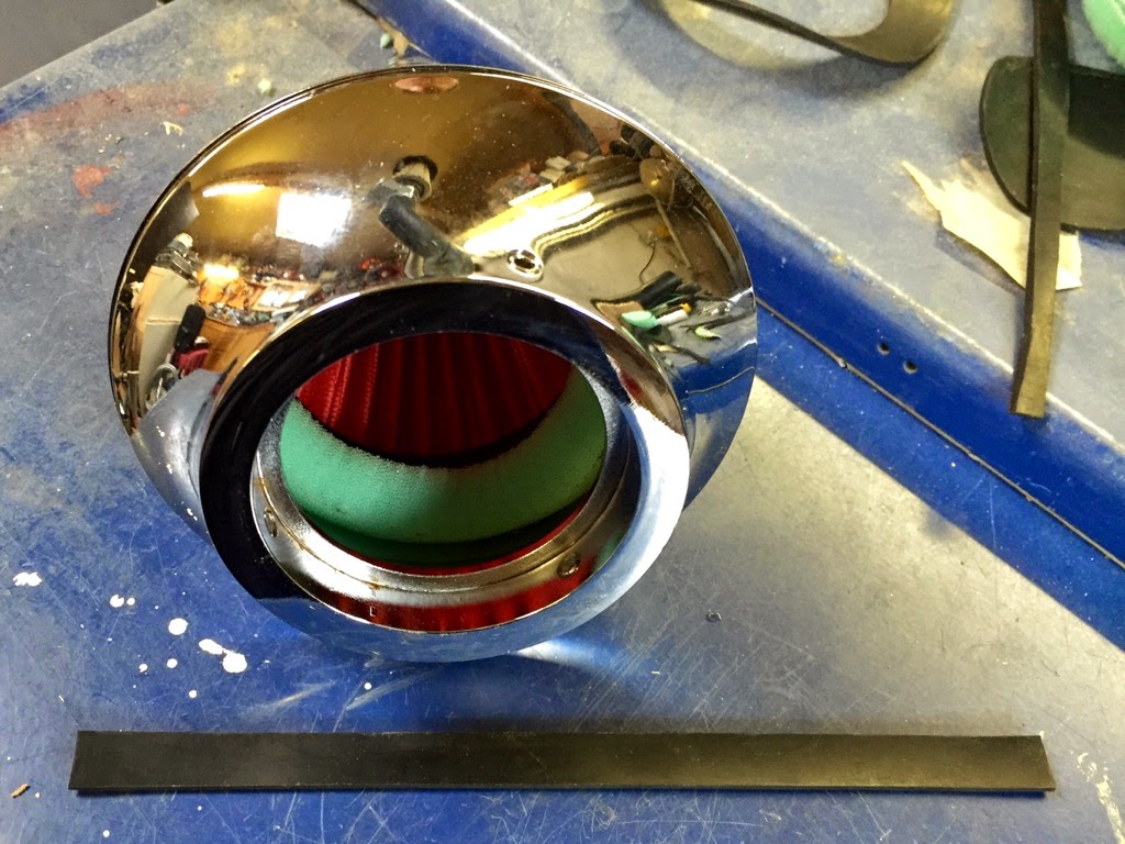

| I just fitted the spike cone filter yesterday, and it was a bit of work because I wanted to mount it as high as possibly to get out of the way of my leg. I still need to clean up the brackets and paint them, but a few things bothered me with this filter. 1. The filter it self seems a little loose, and can move around in there cone housing. I think it could be fixed by putting a bit of foam in front of the filter, to slightly press it back. 2. There is no gasket between the cone housing and the pipe bend, only three small pilot screws. Did you have the same issues, and did you do anything to correct them ? | |

| I cut about 15mm of the tube part of the aluminum connector, that goes into the rubber boot under the tank. This meant I couldn't angle it very much to keep the filter from pointing slightly down, making the two small brackets a lot of trial and error bending I have fixed the issues mentioned earlier, with a bit of foam and a rubber strip around the inside of the cone. After test driving today, these are my findings: 1. Induction noise is much lower than the Naked Jugs filter. 2. Maybe low rpm torque is a bit improved, and it has suffered a bit in the higher rpm. This makes me think the Naked Jugs filter is the least restrictive filter possible. 3. There is no problem with leg room, as my leg hardly touches it. 4. IT LOOKS BLOODY COOL !!!!!!! and I will for sure keep it on the bike. | |
